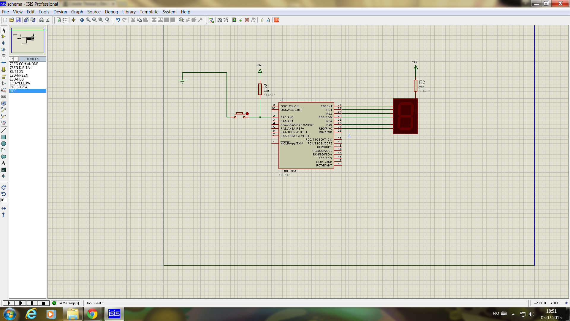

I'm a beginner in assembly language. I have written an .asm code in which I wanted to use a PIC16F876a and a 7 led display to count from 0 to 3.
I have uploaded the code in the '7counter.asm' file along with the ISIS schematic that I've used for simulation.
Everything seems ok to me altough when I simulate it I can only see 1 on the 7 segment display, it does not display any other number.
Any help would be much appreciated. Thank you!

By the way another question. I tried lighting up the segments one by one and here's a really weird thing that's happening. I light up a,b,c no problem but when I try to light up a,b,c,f,g for example no segments will light up...so basically I can only light up 3 segments at one time if I try lighting up more the display will not show anything...that I really don't understand.
Again , Nigels tutorial has the answer.
You can see here, that you have to use individual resistors on each of the segments, you cannot put different currents though that single resistor and get the same brightness /voltage in the segments.

No resistors would allow too much current to flow which, in real life, could damage your display, chip, or both. Using a single resistor, however, severely limits the current, so much so that it cannot support lighting up multiple "LEDs" (segments) at a time.

I was simulating it in proteus virtual simulator not hardware.
Wp100 I have managed to make it work by interconnecting a decoder between the PIC and the 7 segment led display.

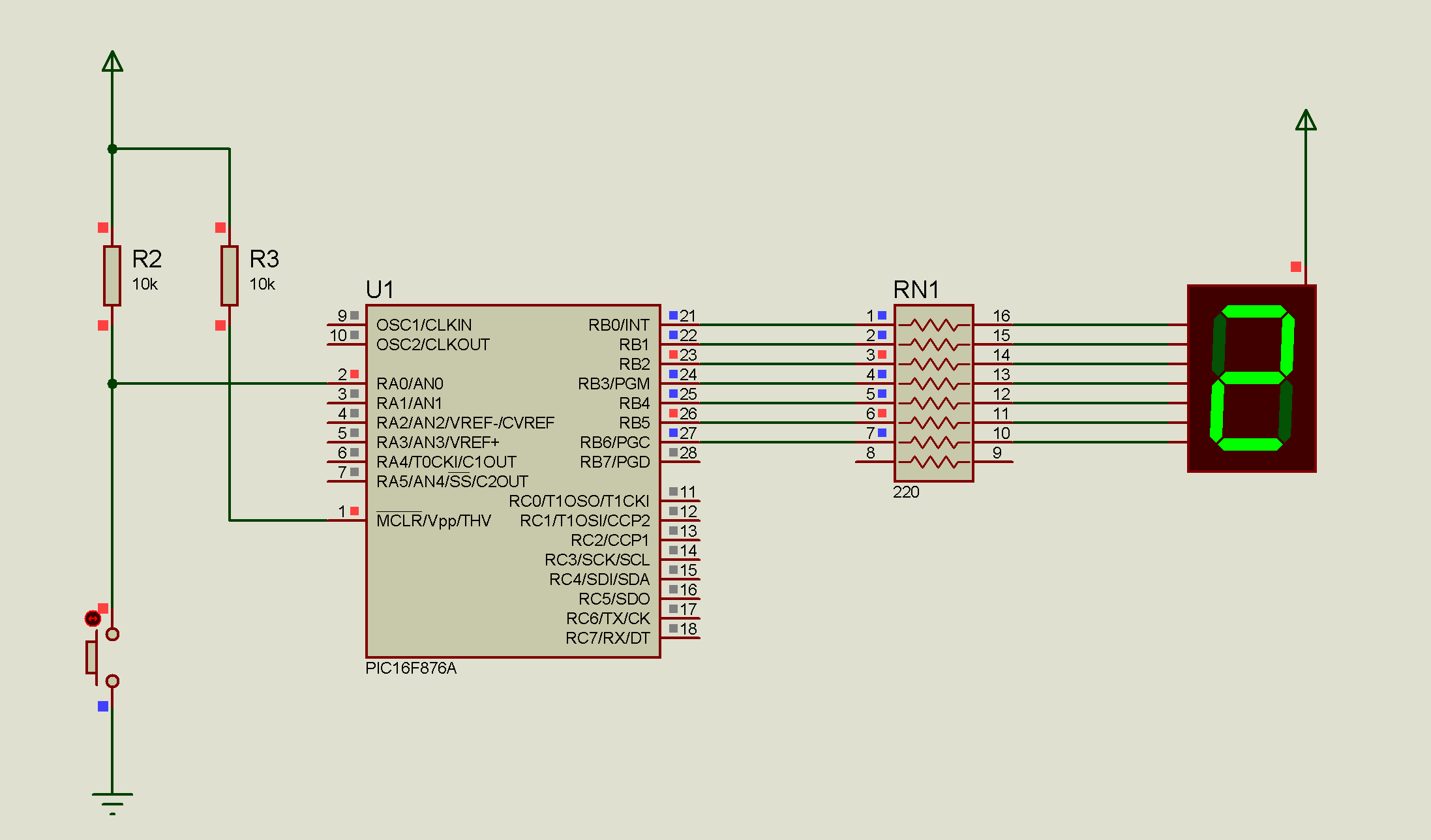

Your circuit should work if you take advice from the above helpers. Without a resistor on each segment, the display only works when displaying digit "1" as it has the least number of LED to light. digit "0" and "2" will not light as they have more than 2 segments.
I didn't modify your software. It seems OK after I add in the resistor network.
Allen
p/s I see why it works now. My 876a clock was defaulted to 1 MHz.
