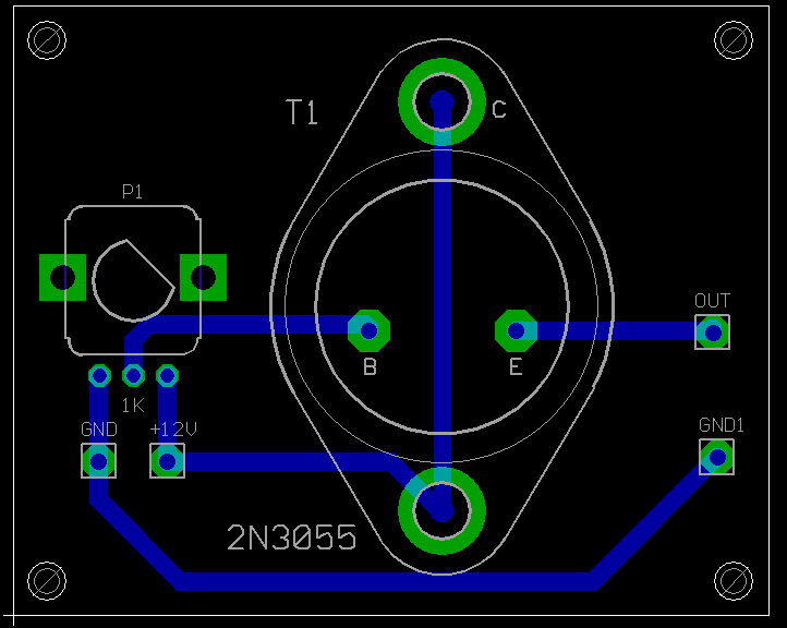

Here is a primitive "regulator".
Adjust the pot for the desired output voltage. The maximum will be approximately 0.7V below supply voltage.
(The "electronic work horse 2N3055" can stand a lot of pain before it dies).
Boncuk

Sorry but i'm a beginner and i think i'm not able to understand those circuits. Should i use a transistor with the potentiometer?

The transistor acts like an amplifier which boosts the current.
Two transistors are better than one.
I suggest you try building a few circuits and see for yourself.
Even better, replace the single transistor with an Sziklia pair.

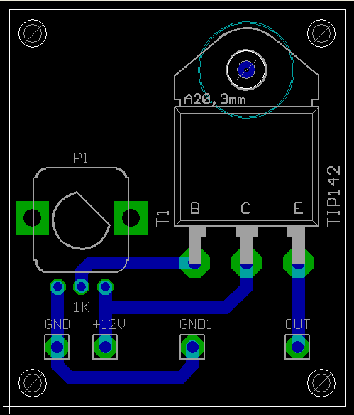

Here are the revised schematic and PCB layout. But I don't see any advantage over using a single NPN power transistor - except for lower maximum output voltage.
Regards
Boncuk
To Stefano,
using a pot to regulate power the maximum allowable current depends on the capabilities of your pot. If it is wire wound for high current you might use that. Better use a normal (carbon film pot = cheaper) and a power transistor.
You don't have to know much. Just build the circuit as shown in the PCB layout. Nothing can go wrong if you don't mess it up with a short.
I have been using that kind of "regulator" to charge the batteries of my electric razor for more than six years without problems.
