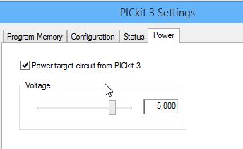

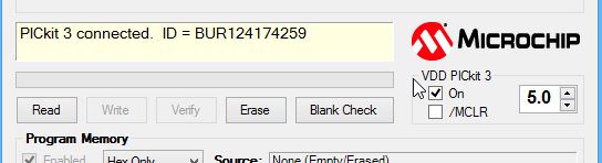

Have you got the PK3 powering the 4550 after its programmed ? if so is the Pk3 power turned on ? - depending on which IDE /Pk3 software you are using, there is always a box, somewhere to turn VDD on.
