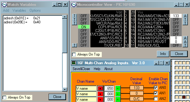

It reads the ADC ok for me on the Oshonsoft sim.
What values are you loading into the MPLAB Sim for the ADC to work with.?

Hi ericgibbs
I am using Microchip PICkit2.
I see that you are able to simulate an analog input. As for me, I am not able to provide an input to the simulator.
When I load the program into the PIC it is supposed to read the voltage connected to the input. The ADC input has a 10k variable resistor connected to it. This allows the input voltage to be varied between 0 and 5 volts. The simulator LEDs do not change when I vary the input.
Hi ericgibbs
Check your ADCON0.GO bit test sense after BSF ADCON0.GO
I found in the sim it was reading the ADC every other pass thru the subr..
