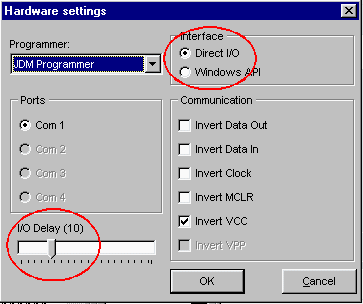

Can you try changing these options to see whether it helps?

Hi eblc,
Tried those options but no luck there. I guess I just don't understand why it would work for 2 out of 5 chips but not the other 3.

Does the voltage goes from 4.7V to zero voltage when you "tick" the checkboxes? If so, then it is highly likely that the three chips are bad.

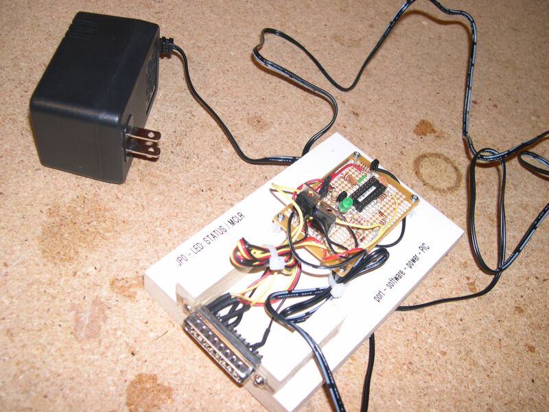

Hi all,
I just wanted to post a follow up and let you all know how things ended up with this. First off, thanks for all the help that everyone offered.
In the end I went with the advice to build a new programmer. I chose the NOPPP Programmer (http://www.covingtoninnovations.com/noppp/) because it supplies it's own VPP, and also because it was a Parallel interface instead of serial (based on all the feedback I got on that).
I also replaced my 16F84's with 16F628's and I love them. I've built my new programmer and it works on all the chips that weren't programming with the JDM. I'm back in business (I'm designing and building a CNC Machine)!
So in summary, I highly recommend this particular programmer to anyone looking for a reasonable DIY programmer to build. Has anyone else had any experience with the NOPPP, either good or bad that they'd like to share?
I'm also attaching a photo of my completed and WORKING programmer!
Once again, thanks to everyone.
