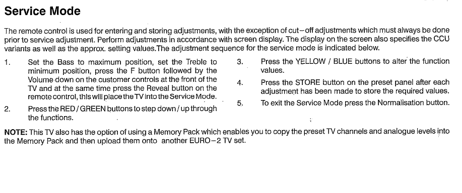

Here's how to access service mode.
Thanks for the information, where did you get it from?
It's just a pain in the bum because I can't find the origional remote!
Luckilly it looks as if it might work with the new generic remote, so I'll have a go.
