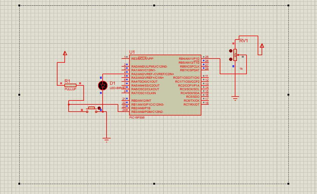

Hi Guys.I need help with this Program I'm using PIC16f886 controller
when I press a push Button a LED should blink , the program works fine
the button is connected to pin RB3 and LED to pin RA2.
Problem arises when i set Analog pin
when i enable analog pin AN11 which is in RB4, RB3 is not sensing Button Press.
i have attached the program can someone help me.. thank you

yes i used a pull up.. i have attached schematic please see it
Okay!!! I think this is a "Protues" issue... ANSELH bit 4 is selecting RB3 instead of RB4..
I have posted a note on Labcenter, Ettore will answer soon... As a quick fix use ANSELH = 0x10; as they seem to match the port bit by mistake.
Thanks Ian . I got the Correct output , I did in actual Hardware and it was working fine . the problem was with PROTEUS
Yes! I used MPLAB sim and its working fine in that!
