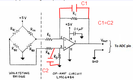

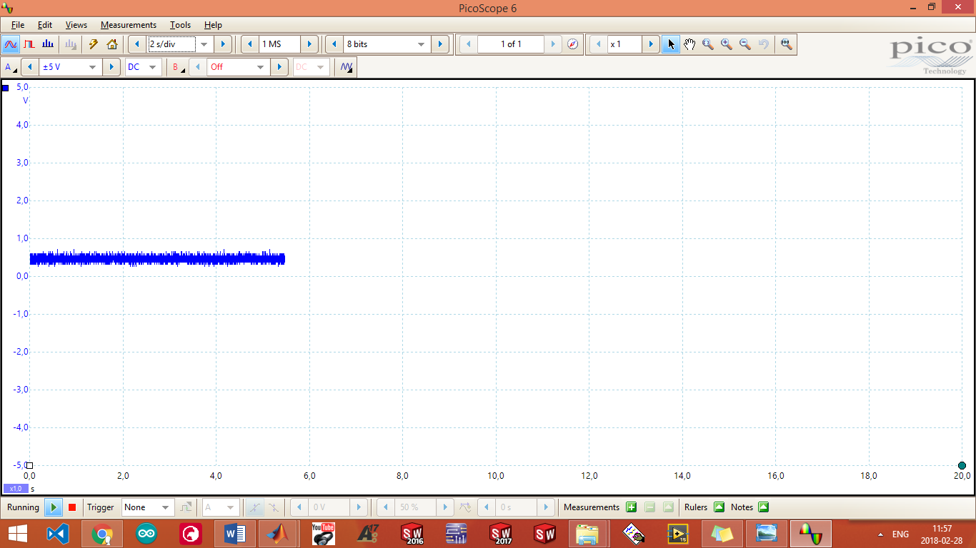

Hello, I have circuit with this amplifier, and with this circuit I amplify my pressure transducer signal from 30mV to 700mV. Amplifier works correctly, when applied pressure is increasing, multimeter shows higher voltage (range 700mV-1.3V). Both, transducer and amplifier are powered from Arduino 5V. Problem is that, when I connect scope cables to circuit output, voltage is decreasing to 500mV from 700mV (700 mV in multimeter) and when i applied more pressure to transducer, signal in scope still is about 500mV and there is no changes in signal amplitude, while there should be some increases in signal amplitude. (i attach photo with scope screen and my schematics).

What is the value of R1?
What is the input impedancw of your 'scope?
What is the voltage at pins 2 and 3?
You would add offset to that poor excuse for a differential amplifier even if the scope input impedance was 10megOhms

Capture the scope trace again, this time with the scope horizontal sweep set to 0.5s.

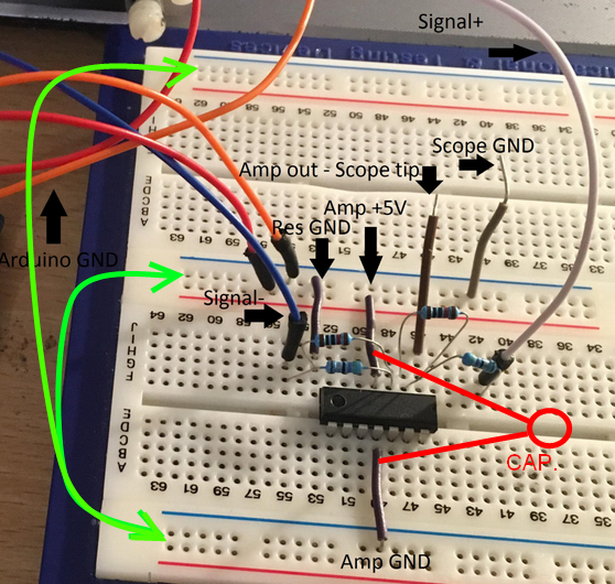

LM-324, C1 and C2 at the moment i didnt use, just resistors and amplifier, o connect the ground clip to the wire, which connected to blue line of breadboard, where also connect grounding from resistor and amplifier gnd pin.

you need an op amp that can operate from a 5V supply. the latest TI version of this op amp can run from a 3V supply, but earlier versions of it required 5V or more (and running it at the bare minimum of 5V was a dicey proposition). you should also have R1=R3, R2=R4 and Rb2= Rb3. Rb1 should equal the midrange value of the sensor.

Op amp is supplied from 5V in my circuit, R1=R3 and R2=R4. Signal drops when i connect ground of the probe to the ground of the breadboard, when only probe tip is connected, signal dont drop.
Well, that indicates a problem right there.
There has to be something odd about the power supply.
Why are you powering your test circuit from an arduino?
Power it from a proper power supply or a battery and see what happens.
Please do a test: With out the scope! Ohm meter where the green lines are. Are the "grounds" connected together? On my boards they are not.
Next add a capacitor from +5 to ground at the IC.
You have IC input pins left floating. They could be part of the problem.
See the ground pin 11 not connected to anything? On another website another kid in his class said it fixed it when it was connected.
