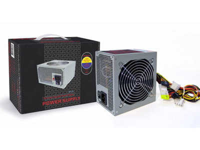

PhillDubya here you are a photo says it all.

You could buy a fanless powersupply if the noise bothers you. Or a large fan type supply they tend to run slower.
Of course you could try the PWM mod in the app note.
it's the CPU fan!!!!!!! :D
