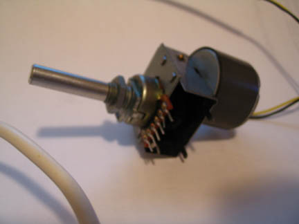

got this from electronic goldmine its a 20k ohms pot ,worm gear driven.

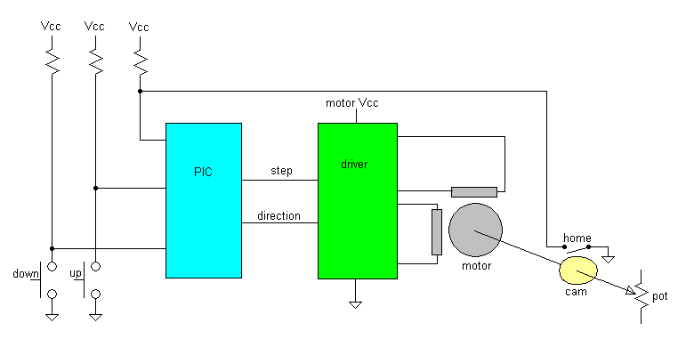

Well, like I said, you should start with a block diagram. Against my better judgment, I've drawn one for you. Once you have one, you can start identifying the pieces.
I showed the motor, the cam, and the pot all on one shaft. Obviously, they could just as well be connected by gears or belts.
If you have to control coil phasing with the PIC, you will need a simpler driver than one that takes step and direction as its inputs.

Hi there, Thanks for your reply. I am not relying on anyone on this project. I just want someone to start me off so I know I am on the right path. I have done some micros in semester one and some basic analogue and digital electronics before. Hopefully I am alright.
As you said, the motor is connected together with the cam and pot in one shaft. I don't really understand that. Can you explain it more in depth. Thanks!

Why don't you explain how you propose to connect the motor to the pot, and how you plan to locate the home position? Then we can give you some feedback on your ideas.

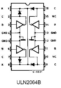

hi there, I have been doing fine with my stepper motor so far. I am now a bit stuck at connecting from the PIC16f873 to the drive (ULN2064) and to the motor. I don't really get what the letters along the side of the pin stand for. I know there are 6 wires from the motor?.. and 4 of them goes to the driver and 2 goes to Vcc, but I dont have a lot of clues hows the pin allocation like.

Do you mean you don't know how to connect the motor, or the driver? Here is a datasheet for the **broken link removed** motor, if that's the one you're using.
