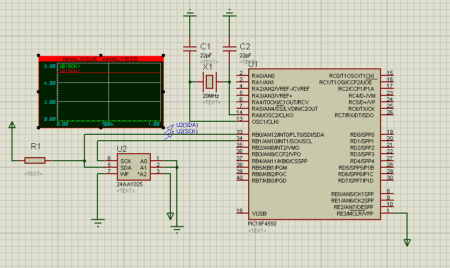

Hi all, i am working on university project that include interfacing pic18f4550 with i2c EEPROM, I read many codes and saw many projects on this topic, after that write sample code from MPLAB C18 ( and i tried many codes also) but no one work with me i dont where is the problem, evrey thing is ok with my code and with my circuit, but the sck did not genrate clk for writing and nothing has been wriiten to eeprom. so if any one can help me plz :S:S
i will attach the code and the circuit schematic.

You need to start() the I2C and write to it like the example I have attached.
(sorry i should have read the code first )
BTW keep the resistors on... It works better

You did what? The code you posted will not work.
Been playing with your code.... The routines you are using.. are for byte size addresses.. you need to use int size addresses.
I have I2C routines for 16 bit chips... You need to set the pins for YOUR chip
I haven't included a sequential read BUT!! in my C tutorials I have... see my signature.

yaaa . i didnt notice that !!!!
i will try your code but if you can give me a small example for writing on any address and reading from this address !?!
If you look at the C code tutorial 6.. There is a function that could easily be used... The same function will read a byte or an array from a small or large eeprom.
Like said there is a link in my signature
