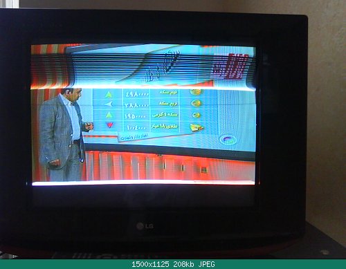

problem with crt lg tv
qasem321
my tv is ultra slim lg
it after 1 hour at top of image creat many horizontal lines
i replace 3 capasitor in vertical zone
100 -1000-1 microf
but no answer

Here is CW81B diagram...
To find the faulty "Cap presumably"...you need the diagram which I have provided....Good luck searching. L.G's are a PITA as they differ from Country to Country even with the same PCB.

In the past I would just hit the caps with freeze spray; it might save some time. Most likely a Filter Cap in the Flyback Primary; like C803.

Check C309, use a scope to check the ripple on the 26V rail, plus check it's 26V with a meter.
Check C311 and C321, the scan coil coupling capacitors.
Check C307 and D302, the bootstrap components.
Replace IC301 - frame IC
