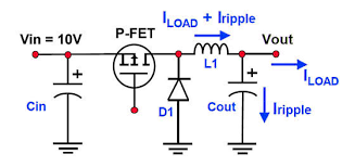

In the following, I put a photo taken from capacitor current and output voltage of a buck converter.
As I know when the capacitor current is positive, the voltage should be increasing.
Can anybody tell me why in the photo, the ripple of current and voltage are almost in negative of each other?

have you tried measuring the capacitor current with both channels at the same time? This will tell you immediately if the scope time base has been shifted
ronsimson, u r right
The current in the figure is the -ic
but, with 100uF capacitor the i=cdv/dt is not satified

only reverse the ic in the photo
I think I measure some noise instead Vout ripples

ajbadi, according to the circuit, when the switch conducts, the rate of rise of current will be a function of the (Vout - Vin). This rate of rise of current will be supplied to the load, which presumably is resistive. As the current rises, the load voltage will rise. The capacitor current should then be C x de/dt, and is a constant.
When the switch opens, the back emf across the coil will cause a circulating current through D1 and Cout and the load current will be discharging the Cout. So what you get is not straight forward.
To measure these ripple currents/voltages, it may be necessary to use the 'AC' setting for the input probe as you have done for channel 1.
