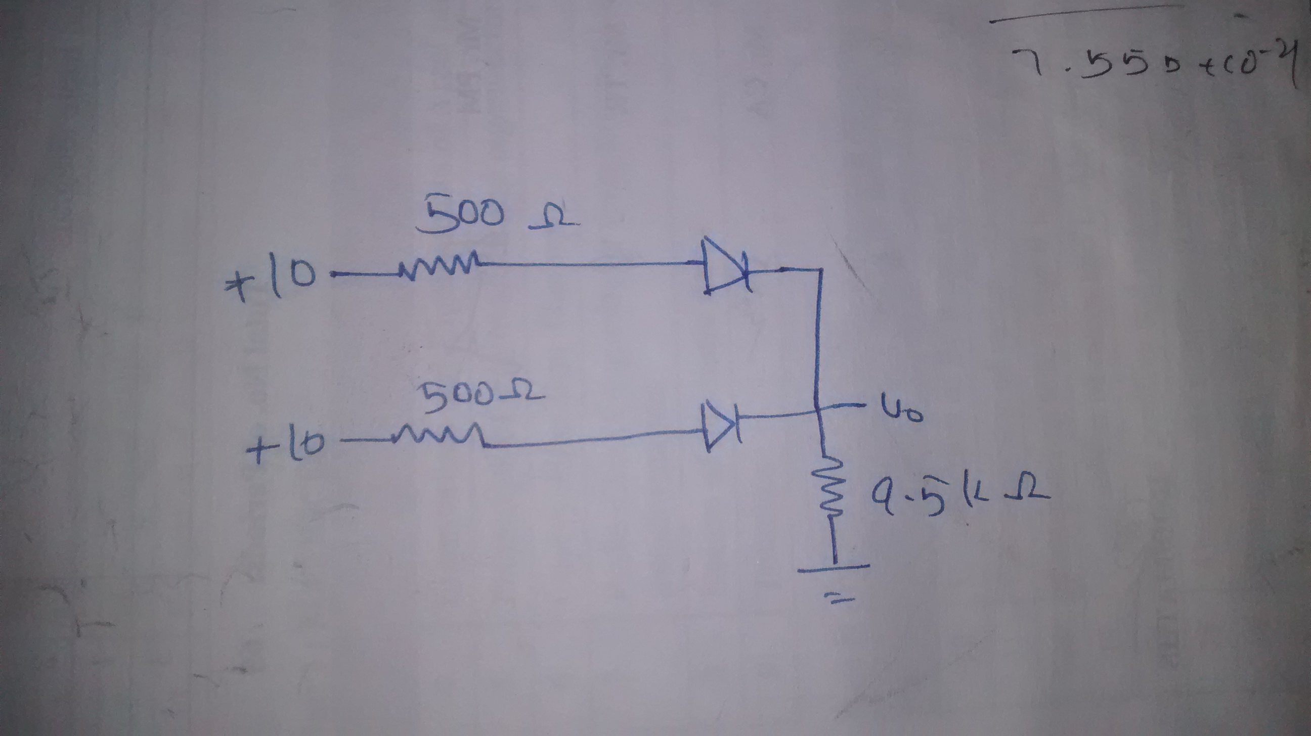

problem in diode circuits
i dont know how to ensure that two diode are conducting .my professor said to remove the diodes and find the current direction ,if the current direction of branch matches with reference current direction of diode then it is on else it is off.Is that way to ensure the conduction of diode or any other way we have

In the circuit you posted, the current in the two diodes is the same (except for a slight difference due to non-matching of the diodes).
Diodes always conduct if the voltage between anode and cathode is non-zero.

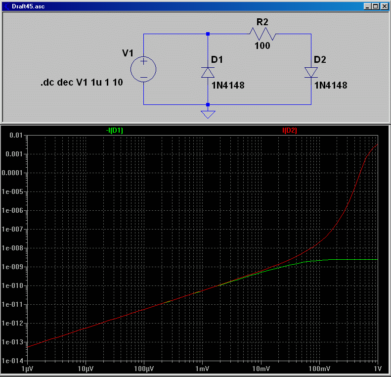

Actually, my point was that diodes conduct when the anode to cathode voltage is negative, just not as much...:cool:
Do you see anyplace on these two plots where D1 or D2 is not conducting?
I'd like to see you verify the voltages you have written on the left side of the page you posted.
Are they both 10 volts, or is the top 10 volts and the bottom 16 volts?
If they are both the same and the two diodes are exactly the same then they are both conducting.
If the top is 10v and the bottom 16v then only the bottom diode conducts.

For an alternate method and this is useful for any model, we can draw up an equation for a diode in series with two resistors:
Vs-Vd-i*(R1+R2)=0
where Vs is the source voltage, Vd is the diode assumed voltage, and i is the current.
For two resistors R1 and R2 and the third R3 the bottom resistor in your drawing, we could draw up a set of equations:
Vs1-Vd1-i1*R1-vR3=0
Vs2-Vd2-i2*R2-vR3=0
vR3=(i1+i2)*R3
For simplicity you might specify the voltages of the two diodes Vd1 and Vd2 and then calculate i1, i2, and maybe vR3 knowing all the resistor values and using simultaneous equations. For these static problems it's usually that simple.
