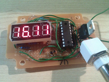

I am trying to build a frequency counter following the instructions at Frequency counter with PIC and 4- to 5-digit LED display. I am using Variant 2, with a PIC16F628A. My 7-segment common anode display only has 4 digits, so I remove the part to control the 5th digit (including R10, D1, D2, D3, D4 and transistor T1) from the diagram.
I build it on a veroboard. Unfortunately, it does not work properly. Upon power on, the display shows a single digit "8." for 1 second (to indicate initialization), followed by "***0" where * represents the top half of a "0". See the following photos. I notice the top half of the display is slightly brighter than the bottom half.
The display seems to be counting the input frequency properly, although some segments cannot be displayed.
Upon investigating the PIC output with an oscilloscope, I notice something really strange:
+ Output of pin RA1 to control digit #4 is either 0 or 5V with no display connected, but drops to either 0 or 2.5V with the display connected.
+ Output of pin RB5 to control segment G is correct when the display is not connected, but always stay at 5V with the display connected.
I have checked all connections and despite the messy wiring, there seems to be no problems. Yet I could not get it working. Could it be because I am using the "A" version of the PIC, or perhaps because the PIC does not provide enough current to drive the display?
Any advice is appreciated. Have been spending my whole Sunday on this.

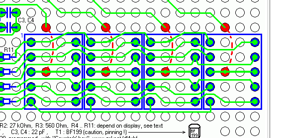

I mean the red wires that are the commons for the LED's.?

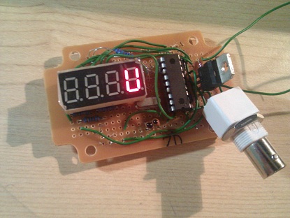

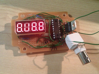

Using your method I have tested again (after resting for a day) and confirmed the wiring problem with the common pin for digits 1, 2, 3. They were confused with the pins for segment A,B,F. For a moment, I was counting the LED pins in reverse direction. This explained the weird behaviour,
Now I have got the frequency counter (somewhat) working, but I realized that it doesn't seem to count properly. Upon powerup, it shows 8.8.8.8 (lamp test) for 1 second as described, then it shows "U" as the digit (short for "undefined", or should it be 0?). Without any input connected, it would either show 16.11 (why this value?) or "U". (See attached image for more info)
My first test was to try with the oscilloscope 2V p-p 1kHz calibration output, which fails, the display would still show "U" or 16.11 (I later understood it's because the PIC16F628 does not have ADC so the frequency counter only accepts TTL signal). I tried to probe the output of a 555 timer circuit which gives 2kHz TTL square wave output, and the display still remains the same. My last try is to connect RA4 to the PIC oscillator itself, and this time the display reads 3.222 (MHz) (why, the crystal I used is 20 Mhz).
Also during some of the display transition, some digits may show U (segment A missing). it's strange because segment A is properly wired, as other digit (2, 6, 8, ...) can be displayed properly. I am not sure if this is a bug of the firmware.
See attached images. Any advice is welcome. :)

When I short the input count to 0V, the display shows U all the time. If the input count is floating, the display may switch between 16.11 (MHz) and U randomly.
I use your method to test and this time, all segments of all digits are lit properly, suggesting that the wiring is correct. If the U should have been a 0, segment A would not be connected properly. But that's not the case. Segment "A" is shown properly for other digits (2,6,8....). This makes me confident that the wiring is fine. Still not sure why a "U" would be displayed in between the digits, and why the counter is not counting properly...

Finally I have gotten it working. The counting is quite precise actually. There are 2 mistakes that I made, even after I was confident that the wiring was correct:
+ Segment a and segment g output from PIC was shorted together, causing funny problems. The "U" display should have been a zero. "16.11" was probably "16.77" (MHz), displayed when the frequency is undefined.
+ The firmware has a setup mode switch (trigger by shorting RA5 to ground) which allows setting the offset frequency). I bypass the the switch but perhaps have triggered the setup mode with some random offset frequency during debugging, so the counting is incorrect. Erasing the PIC entirely and reprogramming it solves this.

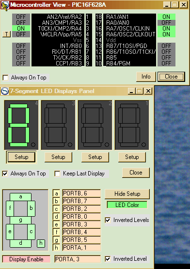

Thanks ericgibbs for all the efforts to help me. I am using counter3.hex (for common anode display). Counter2.hex is for common cathode display, not appropriate for me. I will try a simulation of the circuit like what you did and see if the results are correct.
Attached are some photos of the circuit
