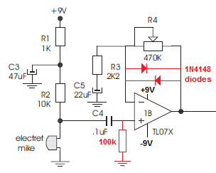

Today I built and tested a preamp for an electret microphone followed by a LM386 based amplifier. Both worked fairly well.
Next step is to include in between, a tunable (variable-state) filter with Gain, Q and filter mode selection available.
My questions:
1) The three stages have gain control by design. I intend to fix the filter Gain =1.
Could / should I , also fix the gain of the the preamp? If so, to what level at the output?
2) I could see in the scope that, by yelling, the electret output can reach up to 250 mV or more. While I do not expect anyone yelling around, shouldn't I consider eventual high levels as that, that could hurt my brother's ears? This is my gift to him if I manage to build something reasonable.
Is here where compression enters the game?
3) The filter requires +/-9V supply. Does it make any sense to use it also with the preamp, taking away both resistors to polarize the noninverting input when using a single supply?
4) A preamp should it be loaded with a resistor? If so what is the value?
5) The DC blocking capacitors at the preamp and filter's output, what value should they have?
Replies and also comments, are welcome. Gracias.
Your preamp opamp will not work because its + input has no DC reference voltage. With a dual-polarity supply the DC reference voltage should be 0V. For a single positive supply the DC reference voltage is half the supply voltage.
The gain control needs to be adjusted so that loud sounds do not cause the preamp opamp to produce clipping.
Yes, loud sounds cause hearing damage. Maybe two diodes back-to-back can clamp the level.
A compressor is used when there is nobody to turn down the volume control with music and speech. It is probably not needed here.

It looks like you have the earphones connected in series and are probably out-of-phase instead of connected in parallel and in phase. Out-of-phase sounds weird.
A resistor from de + input to ground then, but I do not know how to calculate its value.
Could you show exactly what to try and where, AG?
Since the datasheet for the TL07x opamp shows that the Jfets on its inputs produce an input resistance of trillions of ohms then ANY resistor value will be good. If the input coupling capacitor is 100nF (0.1uF film type) then a 100k resistor will be fine for all audio frequencies.
Could you show exactly what to try and where to add clamping diodes?
See my attachment.

I agree with AG's suggestions. The diodes begin to have a noticeable limiting effect when the opamp output amplitude is ~0.5V.

You removed the trimpot that adjusted the gain of the preamp. The trimpot must be set so that the loudest wanted sounds do not cause distortion from the diodes.
OK, I understand the point. :facepalm: :facepalm: Trimpot then!
First step done. The diodes are limiting signal at around 0,5V pk-pk. Good. Have to check but the actual Rf value seems to be is quite less than 470K.
I expect to be testing the filter during the weekend.
Some people shout and others whisper. Some people kiss the mic and others stay away from it.
Our hearing's sensitivity to loudness is logarithmic so reducing Rf to half (235k) reduces the loudness only a little. 47k will sound half as loud.
