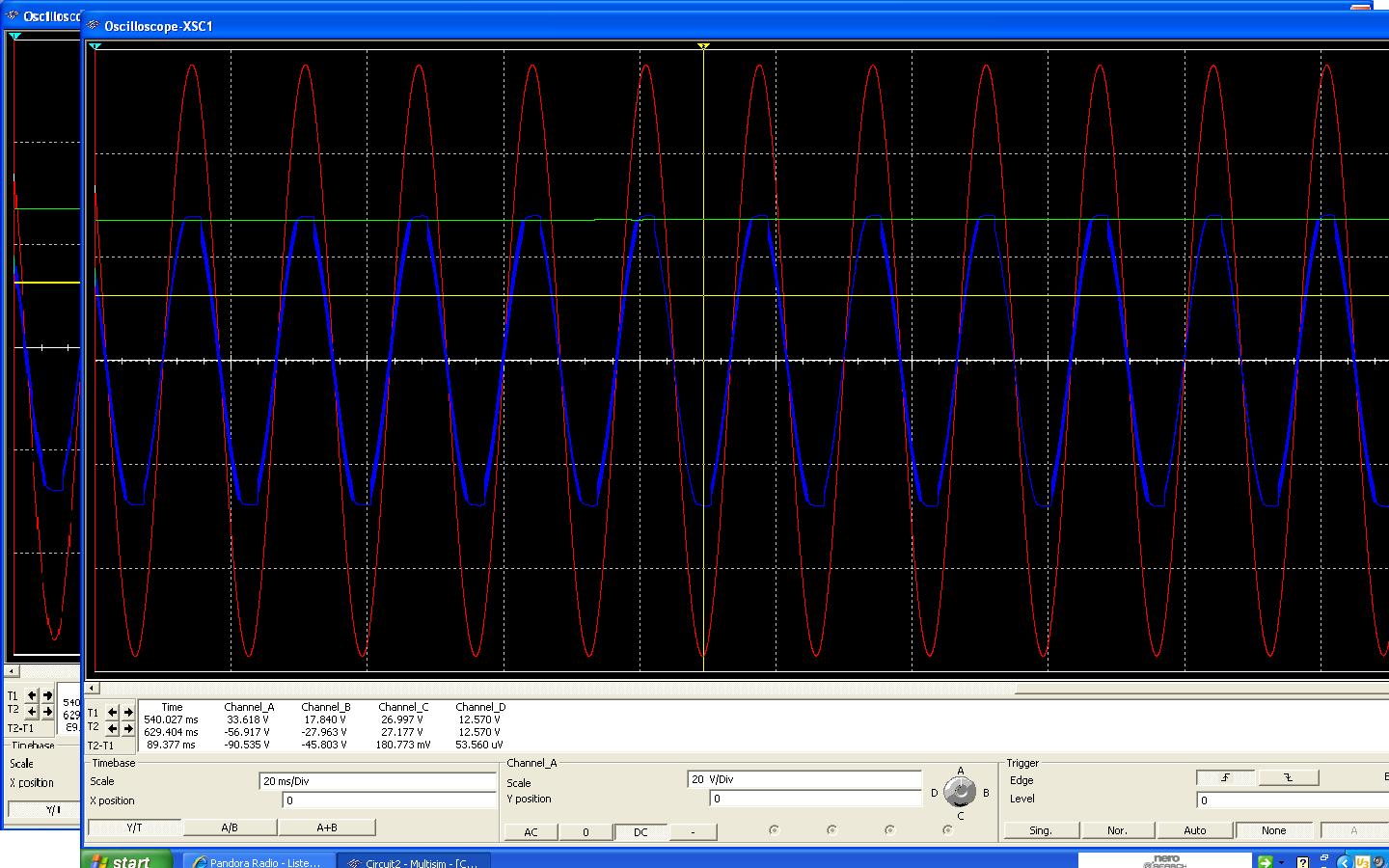

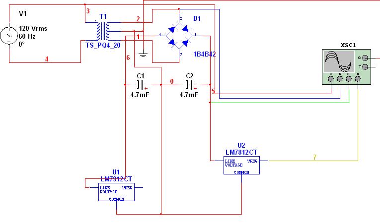

and also, i was using multisim to simulate my power supply and i was getting some weird signals from the output of the transformer.
Those sort of waveforms are what I would expect. The resistance of the transformer is often large compared to the resistance of the capacitor and the diodes, so when current it taken, there is a lot of voltage drop on the transformer. The diodes only conduct near peak voltage, so that is when the current is taken and the waveform is reduced from a sinewave.
