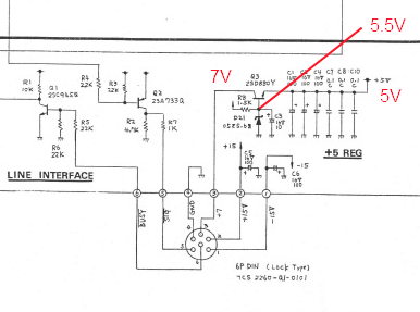

I am trying to repair a Roland PG-200 programmer (a sort of breakout box with switches and rotary controls) that hooks up to a Roland JX-3P synthesizer (keyboard). Here's the rig: http://2.bp.blogspot.com/-5qb9ksPx8io/VPUdoAexD5I/AAAAAAAJYF4/2NxHTKF-vG8/s1600/1.jpg

- The PG gets its power (+15v, -15v, +5v) from the keyboard via a 6 pin cable. The cable's continuity is good on all pins. The keyboard power supply seems to be outputting power as specified.
- However, when connected, the PG's +5v rail is only .33v - so the PG isn't powering on (the 5v rail drives the switches/CPU, the 15v have something to do with the rotary encoders, I believe)

Thanks for the quick reply! So, you're suggesting that I check continuity beginning as far away from the +5V input and working towards it? Ok. I neglected to say that the ENTIRE +5V rail is at .33V. With the PG-200 disconnected, the power supply (from the keyboard) to the cable/connector is about 9V. With the PG-200 (the "next board", as you say) connected, that drops to .33V. Seems that the 9V is supposed to be regulated to +5V at the input to the PG-200, with a Zener/transistor/capacitors circuit. I have checked all those out of circuit and they seem to be good.
I can not see what you see so this might be hard.
On the connector there probably is 7 volts. (might be 9V)
Q3 should make the 5 volts. There is no 5V.
>Maybe no 7 volts!!!
>Maybe bad Q3!!!
>Maybe bad capacitor C3!!!
>Maybe bad D12.
>Maybe R8 1.5k ohms.
Resistor R8 probable connects to +15V and pulls up on D21.
D21 should keep the voltage at about 5.5V
C3 filters noise out.
If Q3 base is at about 5.5V then its emitter should be at about 5V.
