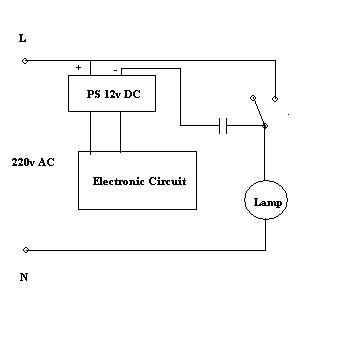

Dear Friends,
I think it's not possible to use this idea. It's completely different.
My idea: Using the line connected to lamp as neutral line for Electronic circuit. I think it's better if we use a capacitor in series as attached figure.

I don't think you're quite there yet: when the switch closes, the power supply has no input. Perhaps a very-low-current circuit, combined with a largish energy-storage capacitor, would do it.
That won't work.
Where do you get the 24VDC from?
If it's via the capacitor, i.e. a transformerless power supply, it'll only work when the switch is open.

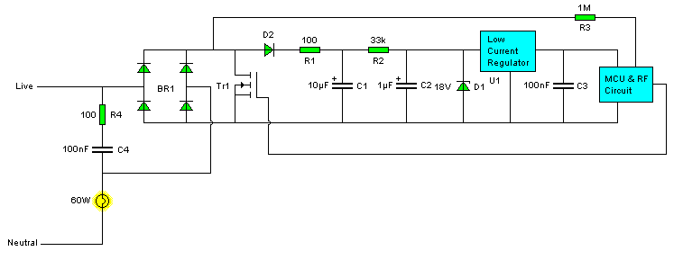

Here's an idea.
Tr1 can't be on for too long, otherwise there won't be enough power for the MCU.
R3 is a current limiting resistor enabling the MCU to perform zero crossing (when Tr1 is off anyway).
Tr1 could be an SCR but it has the disadvantage of having to wait until the end of the cycle to turn off.
The voltage on C2 could be monitored so Tr1 is shut off if it drops below something like 7V, in order to preserve the 5V supply.

Dear Wade Hasseler,
My idea was completely wrong. After charging the capacitor in series with a diode (1N4007), The electronic circuit will be OFF.
DearHero999,
Why do you use TRIAC? I don't need to dimmer.
If D1 is Zener type, Why did you add a Regulator after that?
This idea has a small problem, When the Relay is Open, The lamp is in the 5v closed circuit and so it's not power saving idea. Maybe the lamp will be ON with a low light.
1) You can use a TRIAC as a switch - it doesn't have to be used as a dimmer. Incidentally look up phase control dimming and you'll see that the TRIAC is being used as a switch.
2) I thought about using a 5.1V zener but zeners aren't very good at really low bias currents so I decided to use an 18V zener to pre-regulate the voltage to another 5V regulator. The regulator must be a low quiescent current type. The 5V part of the circuit is only good for a few mA, it's a very low powered circuit
3) What do you mean? Are you talking about my circuit or yours? There is no relay in my circuit. This is not supposed to be a power saving idea, it will draw a small current when the switch is off but it won't be enough to light a bulb, even very dimly.
Dear friend - Hero999,
Thanks for your comments.
1. OK! the dimmer can be usable as switch and dimmer. but this switch is within the power supply circuit. How can it turn ON and OFF the Lamp (220vAC circuit)? We need to a Relay yet?
Could you please about the functionof TRIAc in the circuit?
2. If we use TRIAC as switch or dimmer we can use a high power lamp!?
3. Very good to use the Zener Diode as pre-regulator.
There is no need for a relay.
1) Turning on Tr1 will short circuit the bridge rectifier so the only thing that will limit the load is the lamp in series with the AC side. When Tr1 is on, the circuit is powered by C1. Tr1 can't be left on for too long, otherwise the charge on C1 will run out so Tr1 needs to be turned off for a short period of time every cycle to recharge C1.
2) The circuit can be used as a high powered lamp dimmer or a switch.
I've never done this before, it's just an idea, you might hve to change a few of the component values so it can do what you want. C1 must be rated to 400V and R2 must be a 3W power resistor.
