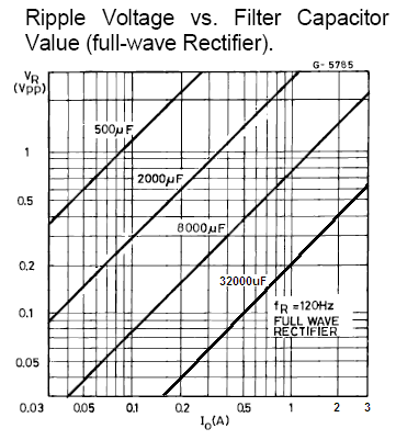

I have a graph for 120Hz ripple voltage. 10,000uF at 3A will have a ripple voltage of about 1.5V p-p and 100Hz will have 1.8V p-p.

Looking at the graph I guess there isn't much point in this case for picking a larger value that 10,000uF.
Thank you very much for everything.
