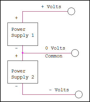

now I have to produce three connections: +12V, 0 and -12V
Not going to work with the supply you have. You have a single ended supply. That is just 2 terminals. The Ground terminal is just that, a chassis ground. What you want could only be done with two of what you have connected in series with the center point being common. If you want +12 0 -12 you need a dual supply which you do not have.
Ron
A dual PSU is configured like the attached image so you know what I mean when I say dual PSU. Note the 0 Volt or Common is not Ground.
Ron
