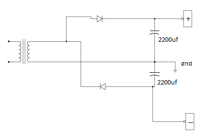

I been playing with this idea it don't look to bad on the scope with big caps the transformer is not a really big one 350mA but i don't need much just playing with some op amps. Should I add a 10 ohm 5 watt resistor to limit inrush current.
One of the capacitors is reverse-connected. Also, just checking, this circuit has been around since the 20's.

I flipped it one times to many I know it's been around a long time kind of like me but. I didn't say I invented it I'm just playing with it I had the caps right I draw it on Linux and it only let me save in .ps so converted that to a png and it looked bad so I cleaned it up in paint and flipped the ( the wrong way you couldn't see what they where looked like two pipes ||.
But that's not what I ask I ask if I need a inrush resistor. Don't think I do because the supply output is maybe 350mA and I'm not needing but maybe 50 mA tops

The Caps are Connected Correct for Both a Positive and Negative Output.
No you Don't Need an Inrush Resistor.

Your rectifiers are simply half-wave that produces double the amount of ripple as full-wave. It will be OK with huger filter capacitors.
The caps are fine I said I forgot to flip them when fixed my drawing. I ask about inrush not caps I should of put my glasses on. Lol.
For +5 & -5 Volts, Just use a 78L05 and 79L05 Regulator.
Put an Additional Filter Cap after Each Regulator.
(Just a 10uF would be Suitable value for these.)

Ripple is a factor of N * RC where 1% is 5RC and Cap ripple current Peak/Average load will be 1/% ripple V
So 10% V ripple means p-p ripple current is 10x Avg load while Caps are rated for Irms current.
Some NTC thermistors drop in resistance 40:1 up to rated current. cheaper than power resistors. This reduces inrush current significantly on caps.
This one starts at 200 Ohms and drops to 5 Ohms at 85'C with 500mA load so you might expect 10 Ohms.
