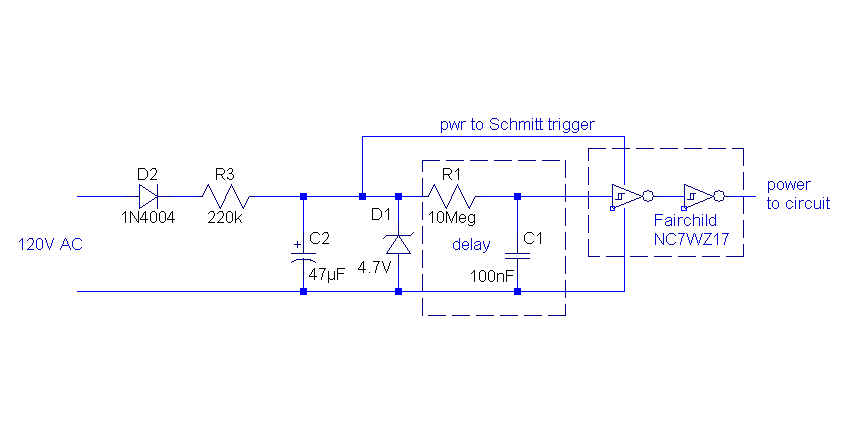

The project is replacing all my wall light switches with touch plates. After several months of experimenting and several designs, I have learned a lot but I'm at the point where I just can't seem to figure out how to accomplish what I want given the constraints I have placed on the project. The touch switch itself is not a problem, the qprox qt118 works beautifully.
The Constraints-

Additionally, the power needs to be referenced to the neutral so that separate circuits in three and four way switch setups can signal with a pulse across the third wire to trigger a flipflop.
The problem is the power for the qprox and a d-type flipflop. I try to simulate all the conditions that could occur like brown-outs, momentary power losses of varying duration, noise, and so on. I definitely don't ever want all the lights in the house to turn on if the is a momentary power loss of any duration.
The qprox wants the startup power applied at a minimum of 100 volts/second rate. The flipflop will sometimes trigger unexpectedly if the voltage is applied too slowly.
The qprox only draws 10 micro amps at 3 volts, and the cmos TC7W74F flipflop even less, so I need a very low current power supply.
Input is standard 120 volts AC. After many different deigns, to best meet the design criteria, I have found a simple diode to 220K resistor to 47uf cap and 4.7 volt zener provides a good 3.6 volts for the chips. Remember that the power needs to be referenced to the neutral wire so I can communicate over the third wire between switch boxes on 3-way setups, so I can't use a bridge. This draws about 400 micro amps from the wall. Transformers were just too bulky and expensive. I have to dump 98% of the voltage as waste heat, but at half a milliamp, it doesn't seem to be a problem. The problem is that the voltage comes up too slowly and drops too slowly during a momentary outage to make the chips happy. I added a resistor across the capacitor to drop the voltage, and decreased the input resistor but still too slow and raised the waste current.
So what I need is a simple, cheap circuit that will apply voltage to the chips quickly and remove it quickly based on whether their is input voltage. My problem is that this circuit will need it's own power supply with the same constraints, which puts me in vicious circle I don't know how to get out of. If the design uses even less than 400 micro-amps, since I only actually need about 50 microamps for the chips, that would be great too!

I think this will work. The delay keeps the output low until the zener voltage has stabilized, then the output goes high within a few nanoseconds. The Schmitt trigger can deliver plenty of current for your circuit.

Excellent. Thank you both.
Looks like the magic phrase was voltage supervisor:) I guess I was avoiding anything that said microprocessor...
Searching through digikey, it looks like one of the simple 3 terminal models like STM809 or MCP100 might work if the RST output is enough to drive the qprox and flipflop.

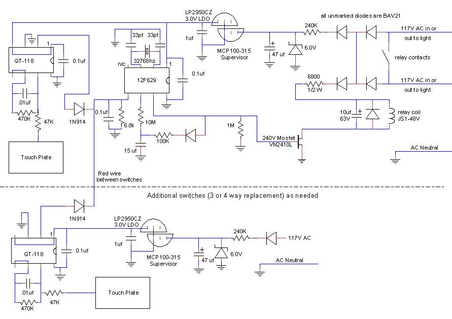

After months of experimentation, I think I have reached my final design.
Since I am just a dumb hobbyist I thought I should ask for someone to take a look at this to tell me if there is some cheaper way to do this (or any other circuit problems you may see).
The 12F629 microcontroller just acts as a glorified flip flop/latch that only responds to the 95 ms pulse from the Quantum QT-118 touch chips (discarding all the noise normally on these AC lines), and stores the current state in eeprom in case of temporary power outage of 5 minutes or less (the time it takes the 15uf cap to discharge below the threshold voltage.]
Attached is the schematic, so any tips before I make the 30 pcbs would be appreciated.
