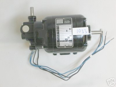

I just bought this motor on eBay:
Or, use this TinyURL, if that link doesn't work for you:
Now I need to get or build a power supply for that. I'd prefer a variable power so I can vary the speed of the motor.
I am not even sure how to get started so any suggestions will be greatly appreciated.

That's a Bodine motor. Search for Bodine on this forum (I just tried it and it works) and you'll find out how to access their motor handbook, which shows you how to control it, how to brake it, etc. Everything you could want is there.
1/50th hp is 15w, so it's 130 mA at 115v, a ~900 Ω load.

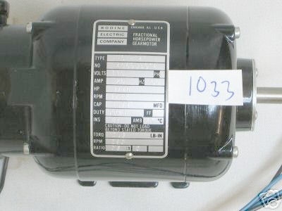

the yellow label says: Bodine Electric Motor
I was wondering how you determined that the motor I purchased was a Bodine motor. I couldn't find any motors on their site that matched any of the identifying numbers that I could read off of the specs plate.
If it looks like a duck, and quacks like a duck...
As it's an older motor, you won't find your model type (NSH-12R) on their web page. You'd have to call them. I have units newer than yours that don't appear there. It looks like NSH refers to a shunt type motor, the R = a right angle shaft. Here's one of my Bodine's, an NCI-12R:

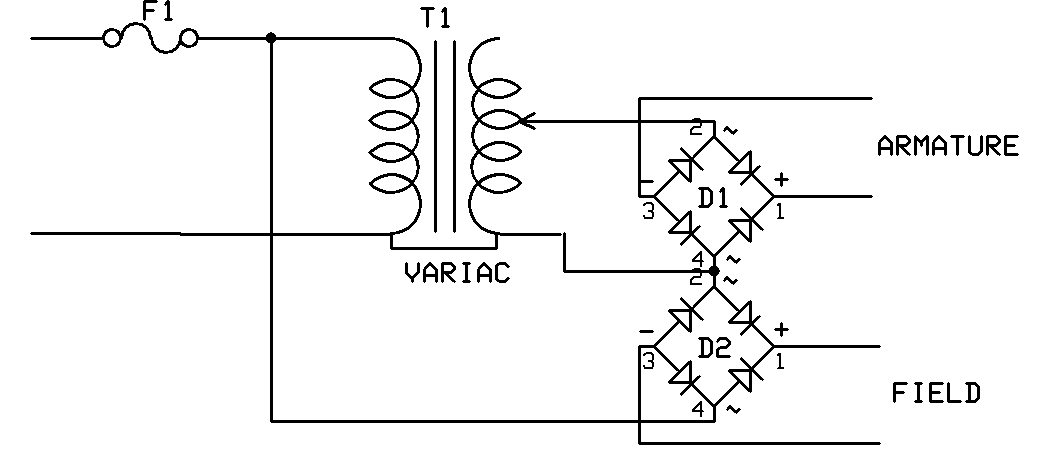

I think this is the way that some of our old lab pumps, with 115VDC motors, were wired. Fairly good speed control and torque.
