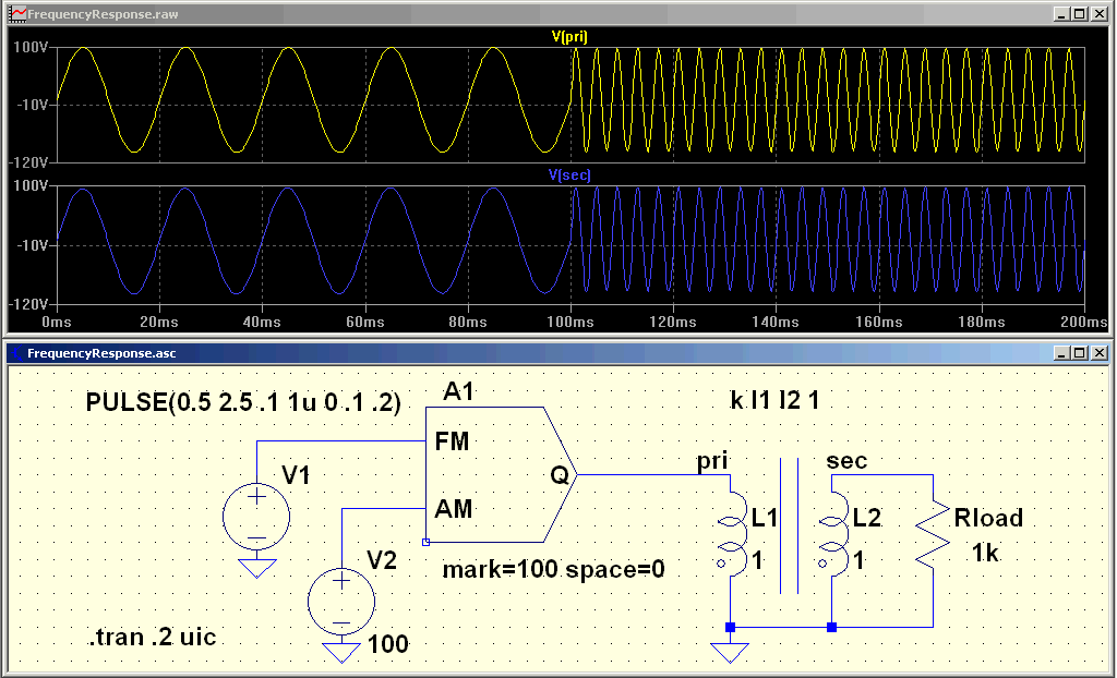

I still don't see how you plan to control transformer output voltage by changing input frequency.
Have a look at this sim, showing secondary voltage unaffected by frequency:

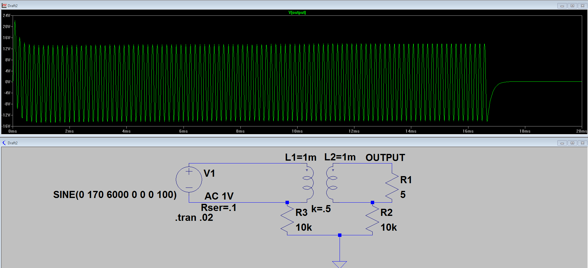

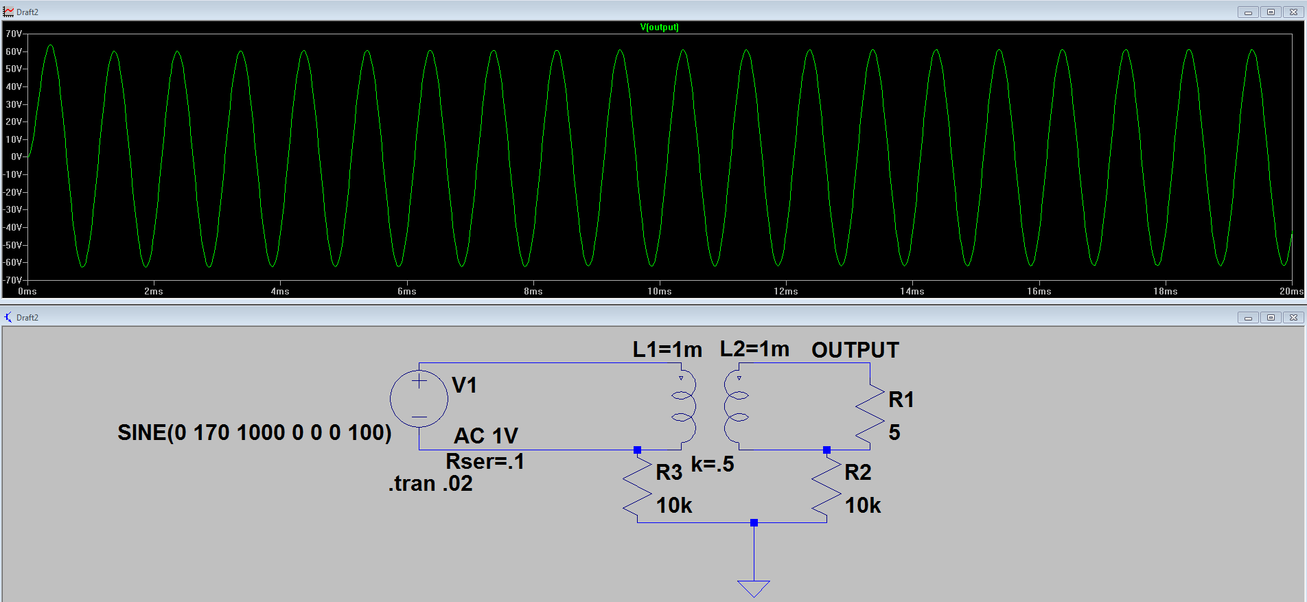

alec_t : Here are two Spice sims using a linear transformer with 1mH inductance in both primary & secondary with a step down of 1/2 as an example.
Note the drop in voltage as a result of the change in frequency from 1Khz to 6Khz.( fixed resistive loading)

K=0.5??? I see you are relying on massive amounts of leakage inductance. Now vary the load and see what happens.

I see that you used k=0.5 in your sim, whereas I used k=1. That explains the difference between the two sim results. Interesting.
