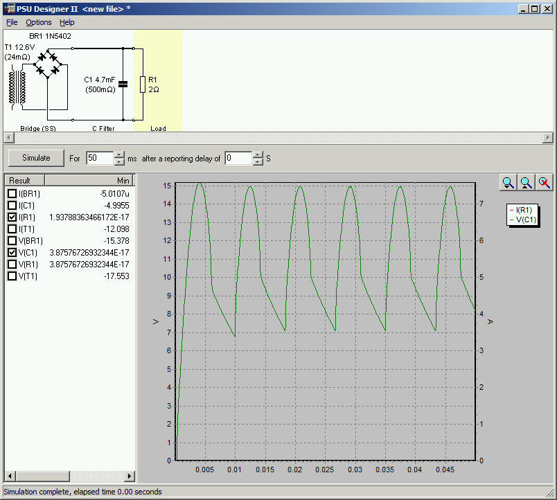

Here is what Duncan says:
Download, put in better values than I did, and re-run. Have fun.
12.2VAC going thru a bridge rectifier (min Vf of 1.25V) will reduce the voltage to 10.95vDC without a load
DC voltage from a bridge = 1.414 * 12.2 Vac- 0.6 * 2 ; DC Current is less than rated AC current.

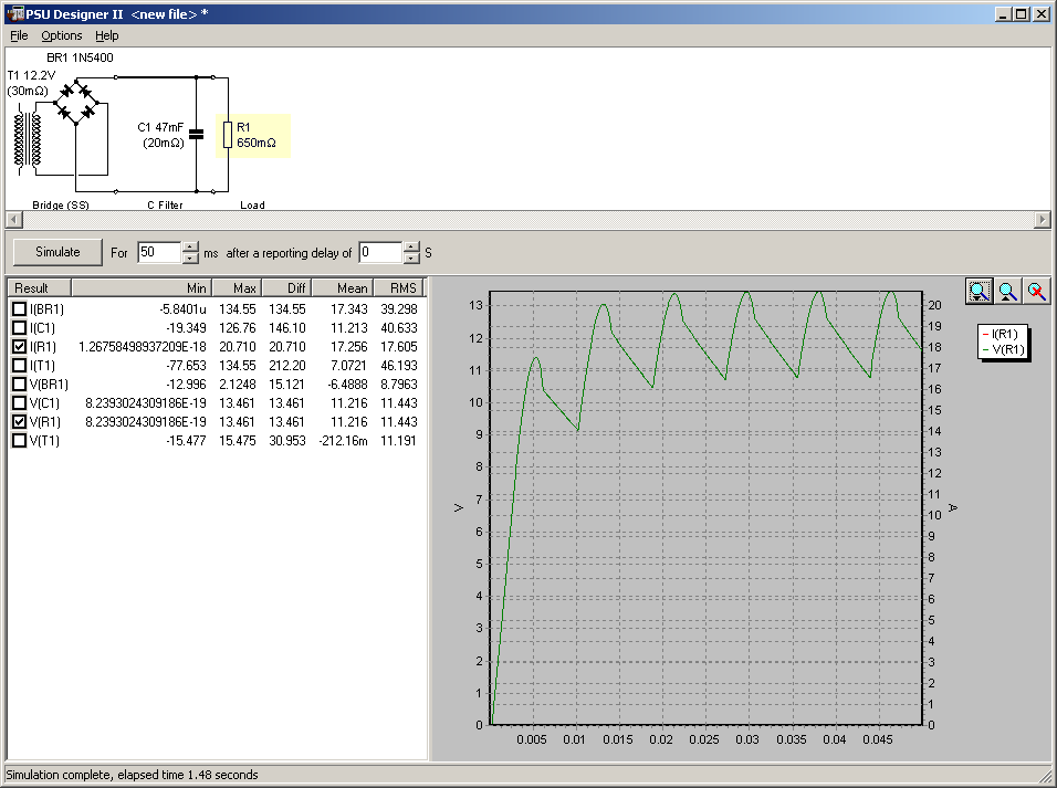

I reran the Duncan simulator with some better estimates of Transformer impedance and Filter Capacitor ESR. Here is what is predicted:
Peak voltage of ~13.3V; minimum voltage of ~10.8 when the load approaches ~20A. The peak current in the rectifier bridge is >60A, so it will have to be a big bridge. You could reduce the ripple some by going to an even bigger filter capacitor, say 220mF which would keep the minimum voltage at ~12V
I got similar results using another online sim. I did not want to complicate the situation but I have two of these transformers in the big box. So I can divide the load current up with a common ground and get away with 14.5A per transformer. At 0.8 ohms 14.5A I got 11.7v with cap of 0.4F (low ripple). I went on Mouser to price 0.1F cap and they are $15 each x 2 = $30 just for the caps then add cost of BR to it. How do these PSU companies build such large-amp devices so cheap? 400W 12VDC for $28 free shipping!

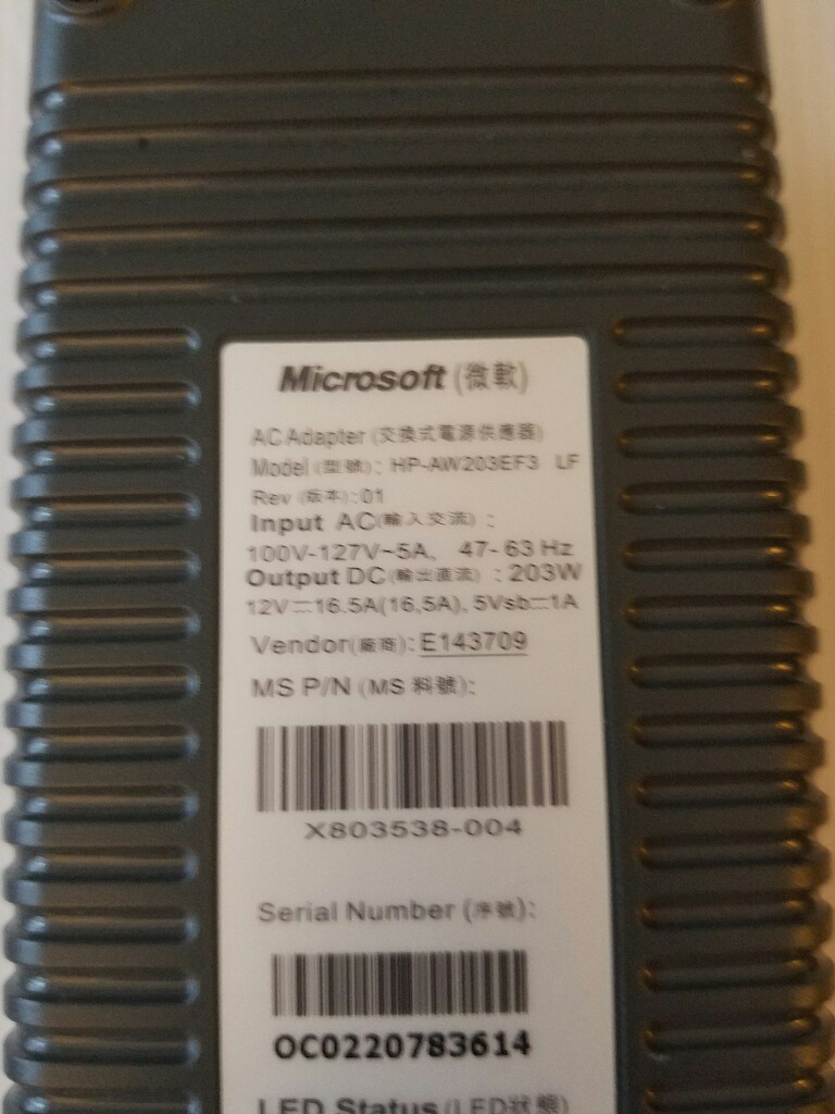

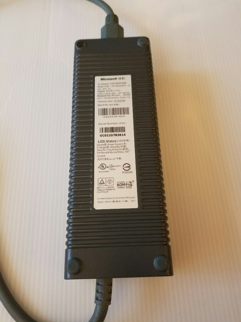

If you want a regulated 12 volt DC power supply at 15+ amps, go to your local thrift stores and look for a Microsoft X-Box power supply. These monsters can supply approximately 15 amps depending on the exact model.

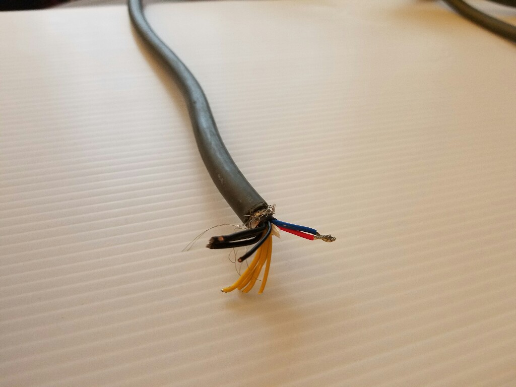

These pictures shows show one of these I bought for 3 bucks over the weekend.
If you cut the plug off, there are 4 yellow wires and 4 black wires to supply 12 volts. There's a red wire that is a continuous +5v. The blue wire must be connected to the red wire to turn on the 12v output.
Is that 4 X 4A 12vdc?
I don't have a thrift store close to me but I can look for similar and/or check with Walmart as well. Looks promising and cheap enough. Have you tested it to see if it puts out that much current? It looks rather small!
No, the wires are in parallel to supply that much current.
These supplies are breathtakingly expensive new but Goodwill stores often have them hanging around for less than $10.
