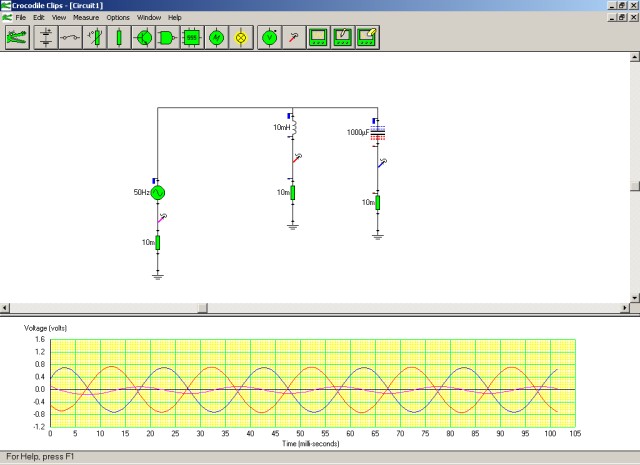

and why does the multimeter show halving of the current if the only thing that is corrected is the phase?
Go back to the equation - if power is not changing, and we assume voltage does not change either, then 'I' must be inversely proportional to cos theta, in order for the equation to balance. Thus by increasing cos theta, 'I' must decrease proportionately.
oh, that's how it works!thanks, didn't quite understand the power factor correction topic in my past basic electrical circuit subject :oops: thanks again :D
To demonstrate - the screenshot of the simulation below. The small resistors are shunts to measure the current on the graph.
In the left branch, we have an inductive current - as represented by the red trace on the graph.
In the right branch, we have a capacitive current, almost, but not quite, equal to the inductive current, as represented by the blue trace.
Note that the inductive and capacitive currents are 180 degrees out of phase with each other.
Now, note the pink trace. This is the total circuit current. Note that it is much lower than either the inductive or capacitive currents.
If the two branch currents were exactly equal, the total circuit current would be ZERO.
(Of course, all this assumes that there is no resistive component in the loads, but in practise, there always is some resistance)
