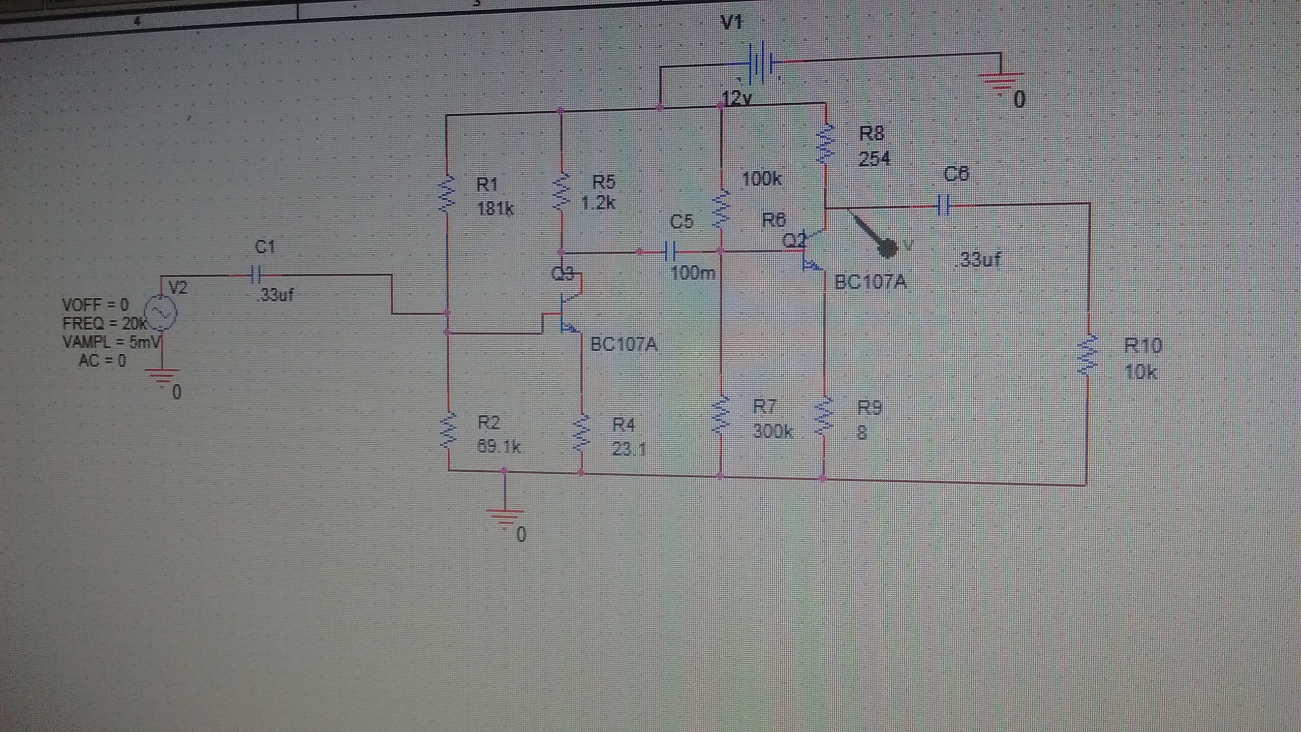

Hai Sir,
I actually wanted to design an audio amplifier and I have uploaded it's simulated diagram below, will this work for an input from microphone and load resistance as 8ohm speaker?
Hai sir,
I actually wanted to design an audio amplifier. I have attached the circuit diagram below. Will this work for an input from the microphone and load resistor as a 8ohm speaker?
There are many things wrong with your "amplifier":
1) Most microphones today are an electret type and must be powered. Yours is not powered.
2) The very old BC107A transistor has a minimum current gain of about 80 then its maximum base current in this circuit is about 63μA. But the resistor values for R1 and R2 are so high that they supply only 50μA. They must supply 630μA or a transistor with a higher current gain must be used. Why are the resistor values so high??
3) The second transistor also has its biasing resistor values much too high.
4) Both transistors are biased wrong.
5) The emitter resistor values are much too low.
6) C5 is 100mF which is 0.1F which is 100,000μF. It will take a few days to charge.
7) The output power of your circuit is extremely low.
8) With no negative feedback the distortion will be very high.
You need to learn the basics about transistors.
