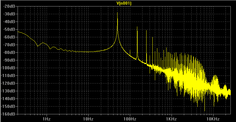

i am an electronics student and doing this project as a part of my curriculum. I want to build a power quality analyzer ,which should detect
volltage sag ,swell and presence of harmonics and glitches in supply, and record their time of occurrence and magnitude . For the project part it's just enough for me to show the power spectra on a glcd. As far as know these machines are commercially available and are used to ensure quality of power supply.
I've just checked the output from a small standard mains 12V transformer, by feeding the output via an attenuator to my laptop's mic input and recording a wav file using Audacity. Here's the FFT as generated by LTspice, clearly showing many harmonics plus noise and so proving it's ok to use a transformer for your project.

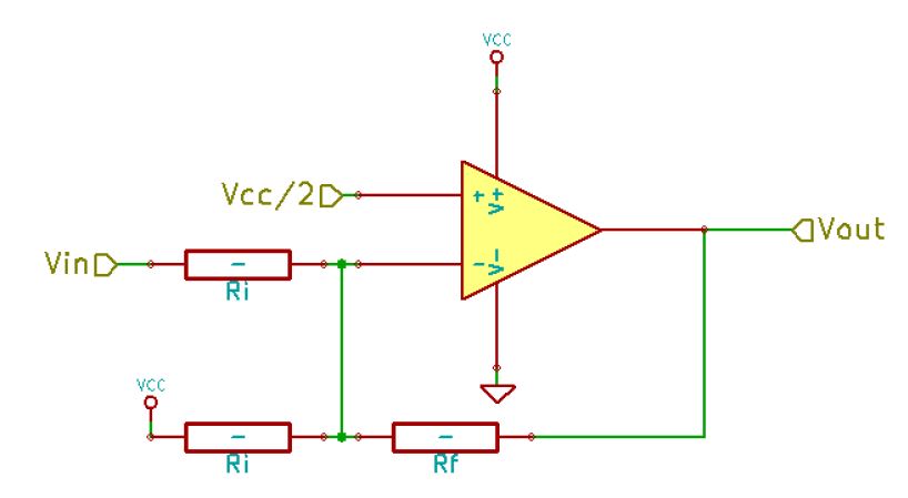

I was just going through a circuit using op-amp in summing amplifier config . just thought if i placed
an opto-coupler at its output i could isolate it . circuit diagram is attached with this .
wish to hear your opinion about it.
Ri = 150k
Rf = 1k

Any power transformer you use should have sufficient frequency response to pass all the spikes and fluctuations of interest. The primary inductance of the transformer determines the magnetizing current, it does not affect the frequency response of the transformer (although leakage inductance can). The primary inductance is not in series with the signal going from primary to secondary.
circuit diagram is attached with this . wish to hear your opinion about it.
Don't use it; it could become 'live' if the input resistor failed. Why not use a transformer, since you may need one anyway to provide power to your circuit?

well i think i would use a transformer to step down the voltage and then use that circuit to further step down to 5v and level shift it by 2.5 volts
could you suggest me a low cost rail to rail op-amp
A standard mains transformer might well pass higher order harmonics, however the core probably wont cope well with lower order harmonics and attenuate them, doesnt mean to say you cant use one however.

I don't think the resistor has a high probability of failing short if you get a resistor of good wattage and high value. I have my power measured that way.
From the safety standpoint, one of the main wires has to be "grounded" (e.g. neutral wire in North America or ground wire in Europe) while the other is "hot". If you connect your MCU ground to the "grounded" wire, it'll be safe. You can make it more safe if you make your PCB in such a way that in the case of failure the connection to the ground stays. This way, even if the resistor fails, the thin PCB traces to the "hot" main will burn down quickly and your device will stay connected to the "grounded" wire - will be safe to touch.
