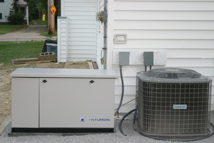

While I can't speak for the entire planet earth I can speak for my modest location. I can't make electricity for less cost than I buy it for. Absolutely no way. Years ago, must be about 10 years ago we did major home renovations and I replaced my small 4,000 watt gasoline powered emergency generator with a much larger fully automatic generator. Here is what it looked like when I installed it.
The unit is a 20 KW power plant when run on propane and 18 KW running on Natural Gas. **broken link removed**. Now if you look at the data sheets for units like this they spell out the fuel consumption so it becomes easy to calculate in the cost of power. Then you figure in the cost of annual maintenance. I still have the gasoline powered 4 KW unit and the cost is much higher burning gasoline over natural gas.
Here in the US we still have a large number of coal fired power plants and many are shutting down because they can't meet the emission standards being set forth by the US government. Anyway, while this generator is great during a grid failure there is no way I can make my own electricity cheaper than I can buy it.
I would never have suspected you could :D
Power plants are something that improve efficiency the larger you make them, your small 'power plant' is far less efficient than a multi-megawatt one.
