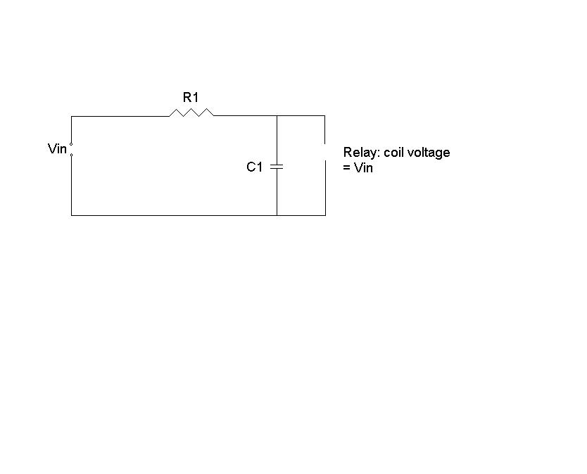

I also am looking for a very simple light weight circuit to delay a 1.5 volt motor to start 10 to 30 seconds,,it does not have to be the same every time.This is put on a streetcar that runs down a track and is stopped by a micro switch and stops the car for a short period of time....Simple and light weight and no relay if possible..
RC time delay
If you just want a small delay, you could use a RC time delay circuit. This is basically a resistor in series with the input voltage and a larger cap in parallel with the output voltage. You would then put a relay or something similar across the output. As the cap charges(in a logarithmic fashion), the output voltage will increase until the relay clicks on, switching 3V to your motor. The bigger the cap, the longer the delay. The time delay(time it takes to charge the cap to 63%) is: t=RC, with R in ohms and C in farads (google RC time delay). Choose these values according to what you have on hand, e.g. large caps = expensive, large resistors = cheap.
Thank you Slosjo. Will I only need a resistor and cap plus the relay? No transistor? Could you please draw a picture of this circuit?

I have attached a picture of what I'm talknig about.
Keep in mind that this delay is not very precise because of the variability of the capacitor. It won't be very long unless you use unusually large components. Look at the equations on the above pages and plug in some values of resistors and caps and you'll see what I'm talking about. Remember that t=RC and R is in ohms and C is in farads. Most caps you work with are in units of micro or pico farads so take that into account when doing your equations.

Depending on how heavy the load is(a small motor, in this case, which can easily be driven by a transistor- i hope!), i would suggest you use a more precise switch as the relay contacts may experience "clattering" if its coil voltage depends on the capacitor voltage which builds up over time. You can use the LM393 comparator with the resistor and capacitor on its non-inverting input and a reference voltage on its inverting input. Its output can then drive a transistor with the motor as its load. This should give a more precise switching.
Hope that helps!
Hope that helps!
I agree, this would probably be a better method of doing it. If you want to keep it a little bit simpler, a solid state relay would functionally accomplish the same thing and also be bounce free like the method above.
