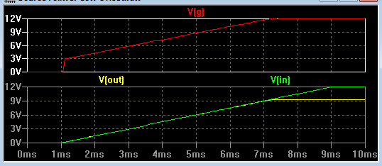

Sure, there is no reason that a power MOSFET can't be used as a source follower in the linear region. MOSFETs are routinely used as the output transistors in class AB amplifiers and the like. Is this buffer just a high or low side follower or a complementary pair?
As you mention, the high Vth is a major issue, so without some kind of feedback from the buffer output there will be a larger offset than the Vbe of a BJT or even a Darlinton pair.
In addition, the higher Vgs will also limit the maximum output voltage swing of the buffer, as even if the gate voltage can swing all the way to the top or bottom rail, the maximum output at the source will max out at VDD-Vgs (or 0+Vgs for a P-type FET).

I know you don't need it for your application, but here's an interesting circuit for your bag of tricks that uses a couple of BJTs to reduce the input-output offset of a source-follower to typically only a few tens of millivolts:

On the matter of Vgs, a couple of things to remember are that this can vary a lot between parts - far more than Vbe for a BJT - so your circuit is not as "repeatable" if you build it again. Also, I believe MOSFETs generally have a lower transconductance than BJTs, so you'll see worse inherent regulation of output voltage over current.
