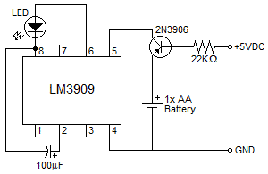

I have a device that's powered by a 5V DC adapter; I would like to set something up so that an LED blinks when power is lost. I already have an LM3909 that will be connected to an AA battery for the blinking circuit, so that's taken care of, I just need a way to turn it on when the 5V power power is lost.
I know I could use a 5V SPDT relay, with the battery wired through the NC contact... but is there anything simpler/more electrically efficient than a relay? I'd like to go solid state if possible.
A small PNP transistor should work. Connect the transistor emitter to the battery, the base to your 5V supply through a resistor, and the collector to the LM3909. When the 5V is lost, the base resistor will go to ground, turning on the transistor and energizing the LM3909.
The base resistor should be sized to give adequate base current to saturate the transistor (0.1 times the collector current, or 0.2 times the collector current if you want to maximize efficiency). For one 1.5V battery, the resistor value would then be (1.5V - 0.65V) / (0.1 * collector current). The collector current is whatever the LM3909 draws when powering the LED.

Fantastic -- I figured a transistor might work, but I was just concerned about connecting the dissimilar voltages.
So something like the schematic in the attached image should work?
I chose 22kΩ because the LM3909 datasheet shows the average drain as 0.32mA, or 0.00032mA, and thus (0.85 / (0.1 * 0.00032)) = 26562.5 and (0.85 / (0.2 * 0.00032)) = 13281.25... a 22k resistor is the closest common value available and falls between those two so it seems like a safe bet to me.
Does anyone see any problems with this?
I have yet to receive my LM3909's (they're on their way), so I can't test-wire this at the moment, but I'm just trying to get everything else lined up and ready to go for it.
EDIT: Fixed transistor symbol

You have the emitter and collector reversed on your schematic.
*waves his hand*
"there is nothing wrong with this schematic"
Anyways, schematic symbol aside, is that how you were suggesting I use the transistor?
Yes, that should work.
