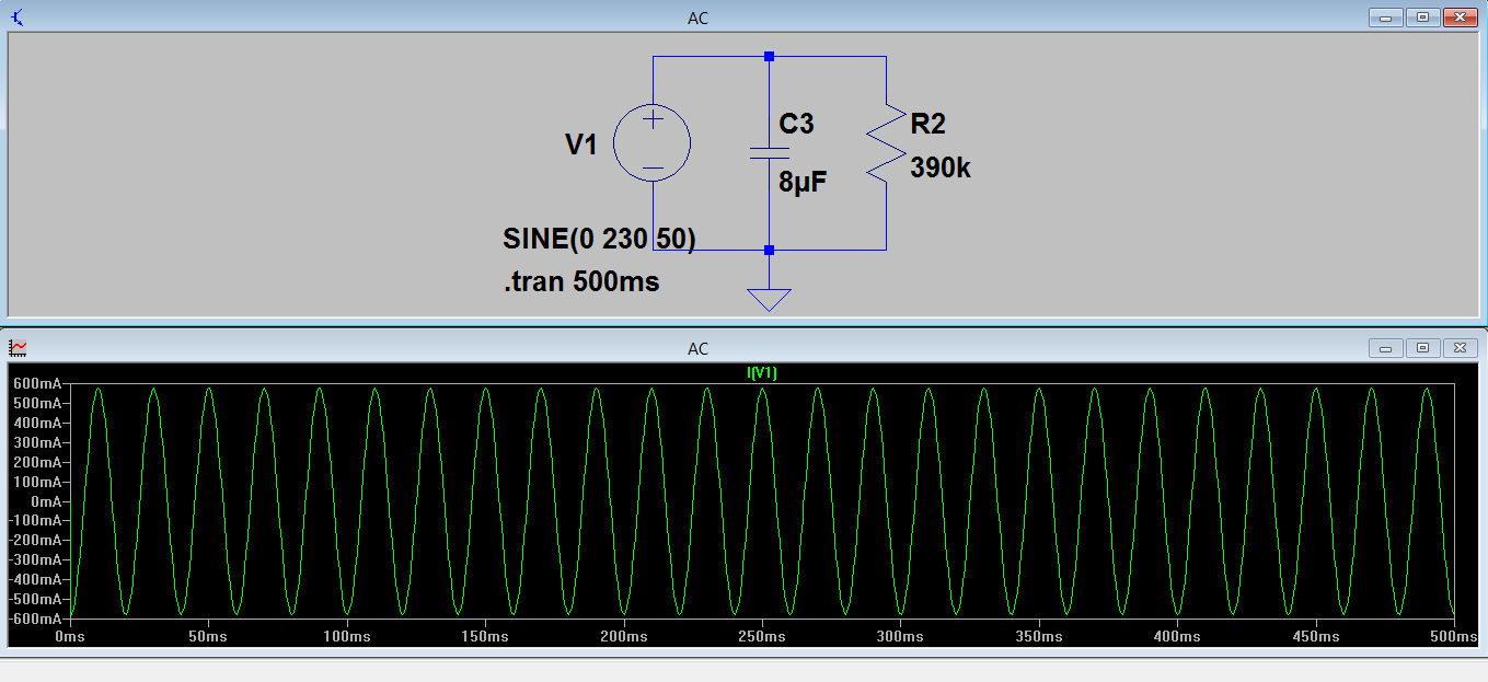

Without a line voltage (230V/50Hz) parallel capacitor, my refrigerator shows Power factor = 0.62 & It takes current exactly 1A.
I loaded a 5uF/450V capacitor to the same power outlet & the power factor increases to 0.82 & the current takes drop down to 770mA.
I have two questions
1) Is there any way to increase the power factor closer to 1?
2) When the refrigerator off (no load) the capacitor takes 350mA current which is too high.How to reduce this standby current?

It is not very economical to add capacitors to fridges and would required ZVS triac switches to prevent surge and lights flickering, although Motor start caps are plastic with higher ESR than general purpose plastic caps. The 8uF at 50Hz is near 400 Ohms and Dissipation factor around 10% can be expected for no name caps.
He can do the homework calculation to increase the cap size.

Suraj, the simple answer to make your motor near unity power factor is to add more capacitance.
How much total is very easy. You need a cap that can deliver 380 VAR.
Since you have 0.62 p.f. @220V*1A=220VA you have inductive reactance stored energy of 380VAR then add -380VAR of capacitance to neutralize. Since Voltage lags current in caps, it is negative. Then your Power can be as low as 0.65 A *220Vac or slightly higher due to imperfect cancellation of harmonics. You can look up how to compute C from 380VAR at 50 Hz and 220V.
If your source does not have low impedance i.e. <5% of the motor coil DC R, you may see a load sag on startup. To avoid this a 1A ICL (inrush current limiter) from Digikey or other, , which are cheap, in series with the cap. all in parallel with the motor. The Cap must be rated for at least 650V or more and a large ferrite series filter will protect it somewhat from 1us rise time lightning surges. This is necessary to protect the Cap and the total cost is why you don't see these parts in fridges.
The LC resonant frequency will be well above 50 Hz but should not be on an odd harmonic.
You can compute this as well using basic engineering.
Is is worth reducing 770mA to 650mA? Only you know thus answer.
