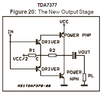

Most IC amplifiers do not have bootstrapping so they have a high voltage loss.
A few amplifier ICs use bootstrap capacitors for higher output power (and better efficiency).
A "new" IC amplifier output stage advertises "rail-to-rail" without expensive bootstrap capacitors. The idle current is low and is class-AB.

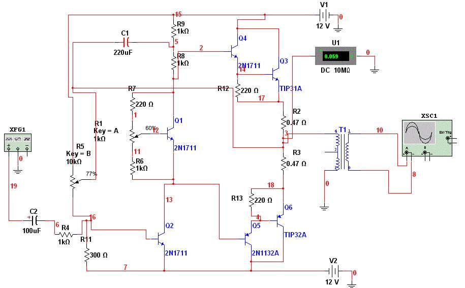

Here is how i was working from the start. Improvments step by step.
It was relativle ok for a normal transformer, except for the gains, but it got complicated with the symmetric input transformer.
Dont mind the resistor values, i was experimenting a lot with them so i just left defaults on pics here.

Atm im stuck on modifying the desing for symmetric input transformer.
All comments and suggestions are most welcomed :)

Your circuits are from the '60ies. The 100 ohm resistors feeding the transformer steal all the output power.
The first circuit has the base of Q4 shorted to its collector so it is a piece of wire.
The remainder of the circuits are better but still very old.

Your circuit does not have an input transformer. It has an output transformer. The transformer does not need a grounded center-tap.
10W at 6VRMS is 1.67A RMS. The peak current is 2.36A. The extremely old 2N1711 output transistor must pass the 2.36A of peak current but its max allowed current is only 500mA and the power through it will melt it. I didn't look at the datasheet for the 2N1132A but it is probably the same.

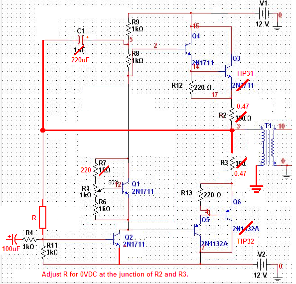

The 2.36A peak current must flow through the 100 ohm emitter resistors. Then they will create a voltage loss of 2.36A x 100 ohms= 236V each. You have only 12V so the 100 ohm resistors have values that are far too high. 0.47 ohm resistors will have a voltage loss of only 1.1V each.
The 2.36A peak output current from each output transistor requires a power transistor like a TIP31 and TIP32. Their minimum current gain at 2.36A is about 12 so the max base current is 197mA. But you have the value of the base resistor at 1k so it will produce only 3mA at the peak of the waveform instead of 197mA. Your schematic with darlington transistors might work.
Your schematic with darlington transistors had so many things wrong that I fixed it without a long explanation. Ask questions if you want.
Can you turn off the chicken pox dots that are all over your schematic?

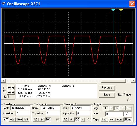

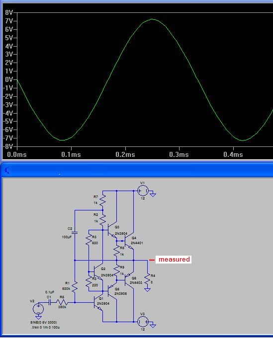

I tryed simulating the schematic you specified but i just couldn't get close to
0V DC at a specified point, and the output was always a distorted square wave with V+ peak pulled down to 0V.
So i tried modifying the schematic a bit and this is the best i could get.
But in any case output isn't what it should be.
Thx for help :)

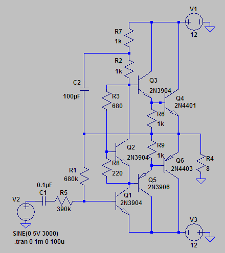

I changed my amplifier schematic slightly and sim'd it. My sim program doesn't have a PNP power transistor so I used little 2N4401 and 2N4403 output transistors instead. They are straining and are smoking. I increased the value of the 3.2 ohm load to 8 ohms to reduce the heat in these little transistors.
I adjusted R1 for 0VDC at the output and R6 is adjusted for a voltage gain of 1.25.
R3 is adjusted to eliminate crossover distortion.
The output transistors probably need series emitter resistors (0.47 ohms) for thermal stability and Q2 should be mounted on the heatsink of the output transistors for thermal tracking. Q1 might need a small value capacitor from collector to base to prevent the amplifier from oscillating at a high frequency.
