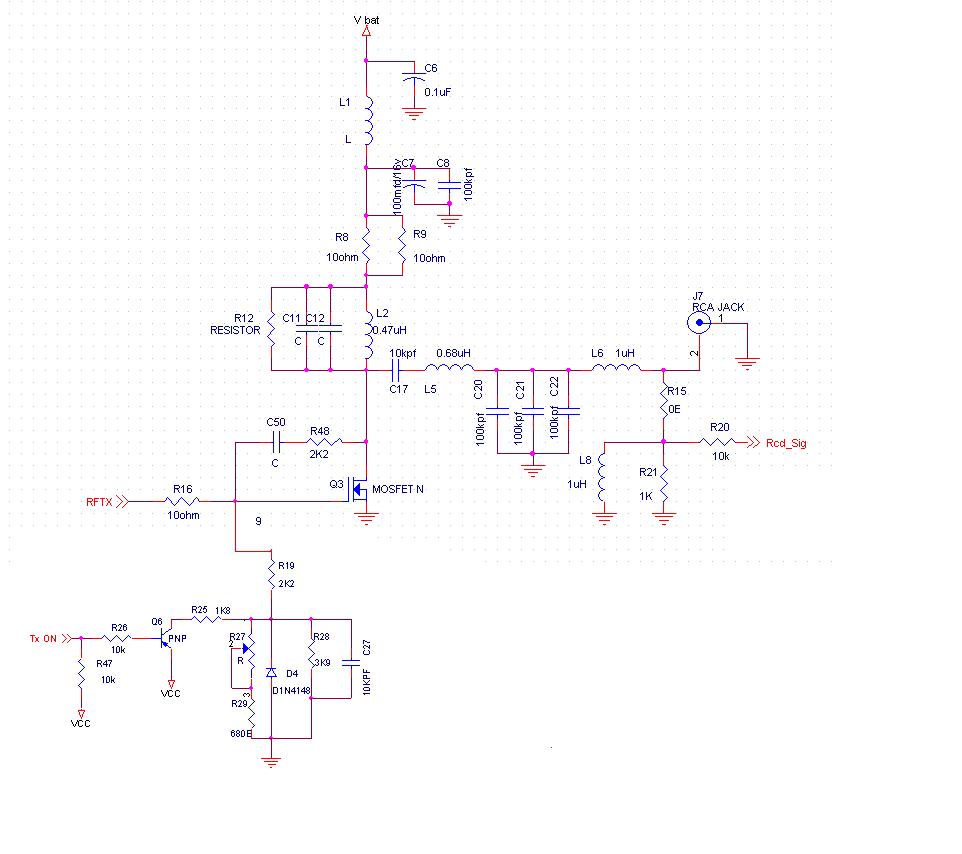

J jaschek New Member Sep 5, 2008 #1 am trying to complete a design started by my RF engineer. A power amplifier for 13.56 mHz. I am not an rf engineer though i know some analog electronics. his power amplifier was something like the attachment, can someone help me complete it and tell me how it would work ? thanks a ton Attachments Copy of untitled.JPG 72.2 KB · Views: 268

R rezer New Member Sep 5, 2008 #3 jaschek said: am trying to complete a design started by my RF engineer. A power amplifier for 13.56 mHz. I am not an rf engineer though i know some analog electronics. his power amplifier was something like the attachment, can someone help me complete it and tell me how it would work ? thanks a ton Click to expand... None of my business, but is this design proprietary?
