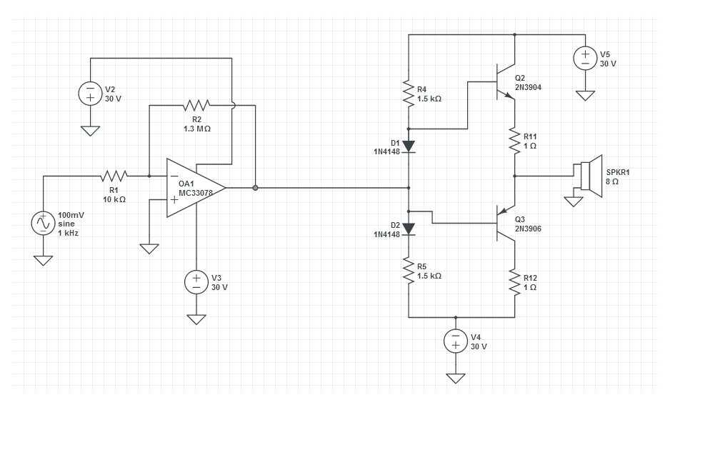

It works but there is a bit of crossover distortion and I probably need to lower the power supply voltage due to the op amp I am using. I am not really sure what I can do to remove more of the distortion and if I lower the rails the way the schematic is the output waveform clips.

R2 is in the wrong place. Move the side at the output of the OP amp to the speaker or if you need more voltage gain than your OP amp can provide, divide the output so it's in range and feed that back. That feedback network can tailor the high frequency response.
and you need a filter at the input so it starts at 20 Hz and won;t amplify DC.
Component tolerences, like different beta's should give you a slight AB advantage. Make the beta 40 higher for one transistor. Crossover should go away.

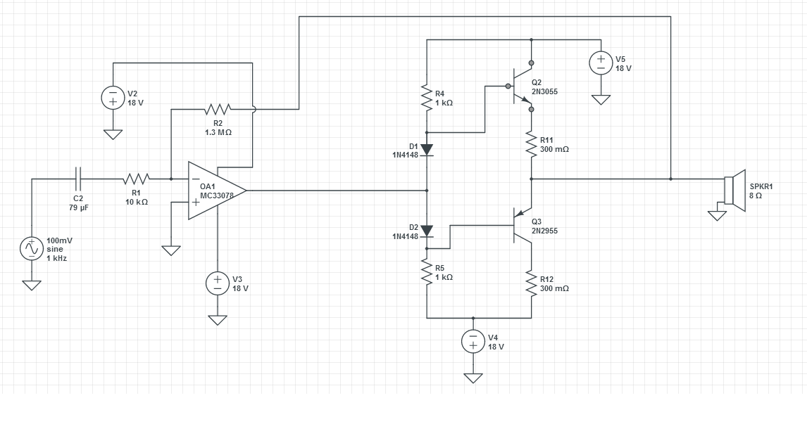

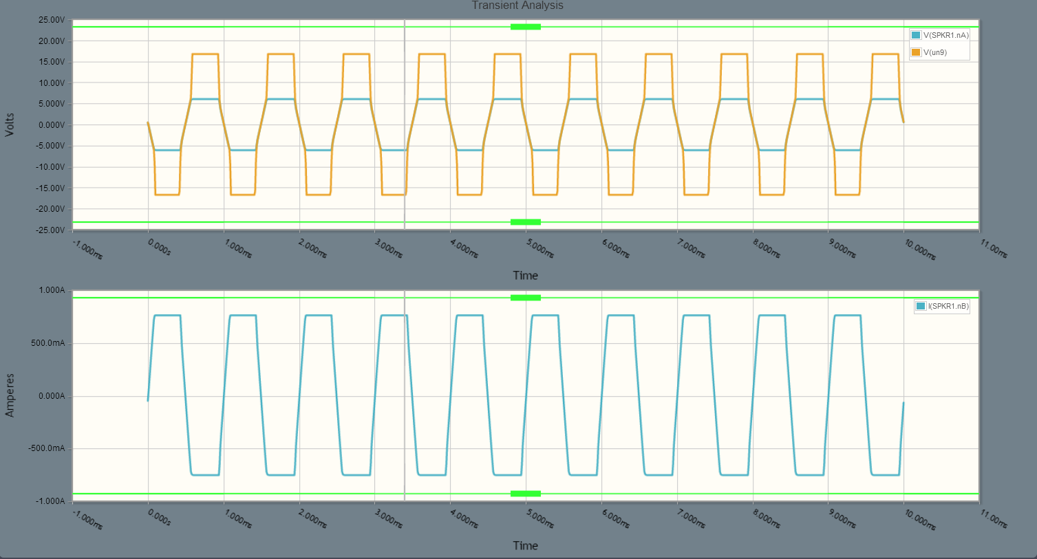

I am not entirely sure what you mean by dividing the output and etc. We were supposed to cover feedback today but professor was sick. Here is the updated schematic and waveforms are also provided. The orange is the output voltage at the op amp and the blue is the output voltage across the speaker.

R12 should be on the emitter. Small thing.
Where is vpin9? I think vspkr is the output voltage.
Are you sure the supply is correct on the op-amp?
vpin9 is between the two diode and yes vspkr is the output voltage. Changing the two supplys on the opamp does not change anything in the output waveforms and same goes for moving R12 to the emitter. It is clipping and I think that is because the opamp only supports 110V gain when I have a 130V gain. I don't really know how to fix it.
Now I see. The output of the op-amp goes from - supply to + supply but the emitters (speaker) only goes +/-5 volts. This is because the current gain in the transistors is too low. R4,5 provides the current into the base(s) of the output transistors.
two options.
1) make more current pass through R4,5. Change to 220 ohms.
2) use a better transistor. (darlington) Or use total of 4 transistors to get more current gain.
You really should go look at amplifiers on the internet to see how this is done. Don't invent this from nothing. Learn from others.
Move R12. Think symmetry.
Remember the diodes should be mounted in thermal contact with the respective transistors.
A potential issue you have now is that the feedback exceeds the maximum input of the OP amp.

Have you calculated currents?
The typical output current from an MC33078 is about 18mA. Then it can drive the 1k resistors that bias the output transistors, but it can't drive a lower resistance.
But can the 1k resistors turn on the output transistors?
If the peak current in the transistors is 0.8A each and their typical current gain is 100 then their base current is 8mA peak.
When the 1k base resistors have a current of 8mA peak then they have a voltage across each one of 8V.
Then the bases have a voltage of 18V - 8V= 10V peak each. Then the output swing is about 8.8V which is an output power of only 4.8W.
Your problem is that the opamp is not turning on the transistors, instead it is turning them off. The resistors are turning on the transistors but they do not provide enough current for a higher output power. If the resistor values are reduced then their currents will be too high for the opamp to drive.
To fix it replace the transistors with darlington transistors (and bias the darlingtons with 4 diodes instead of 2 diodes). The higher current gain of the darlingtons allow a much higher output power.
