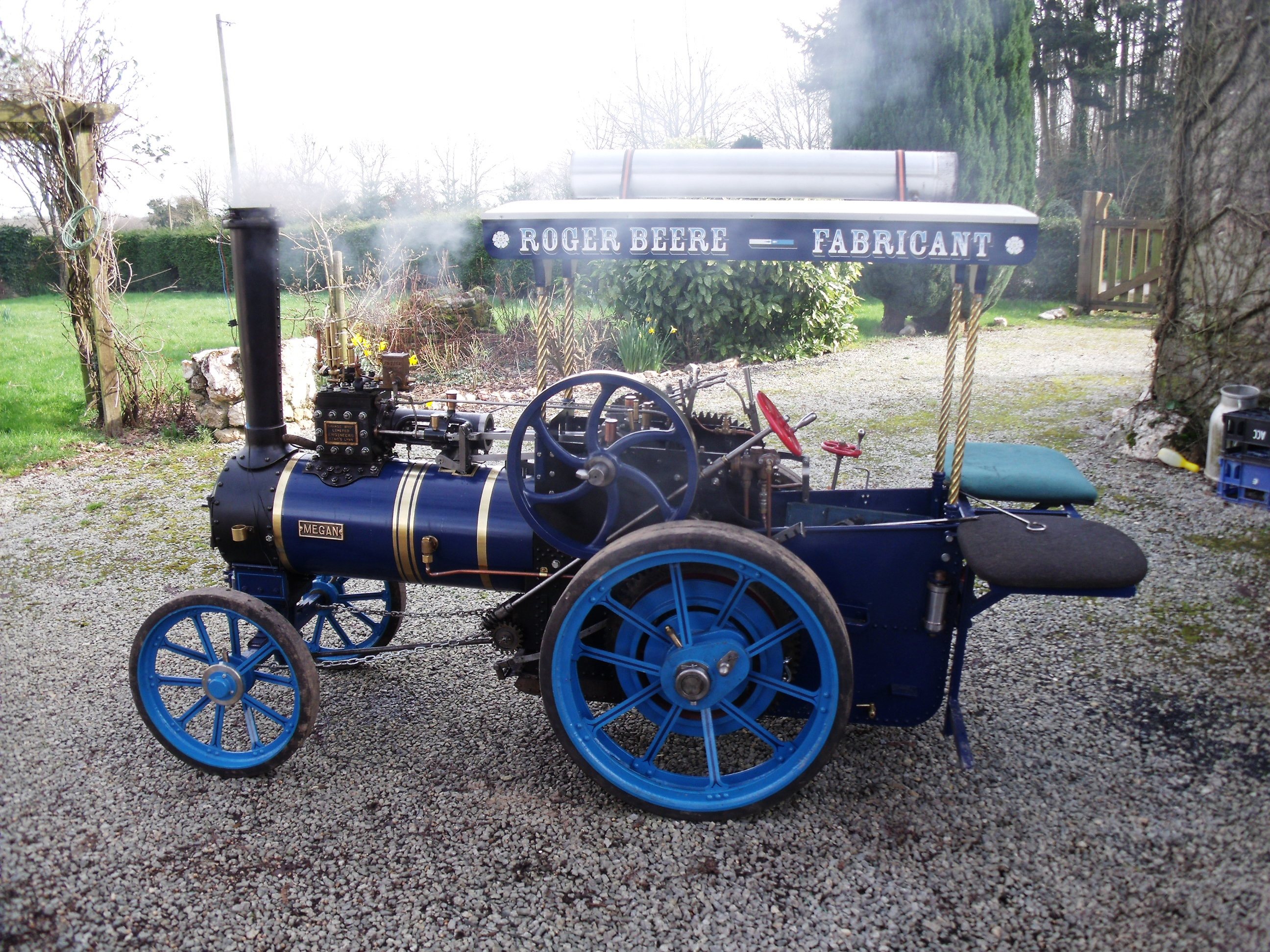

My big boys toy is a half size traction engine. If I knew how I would post a photo.

Nice traction engine.
