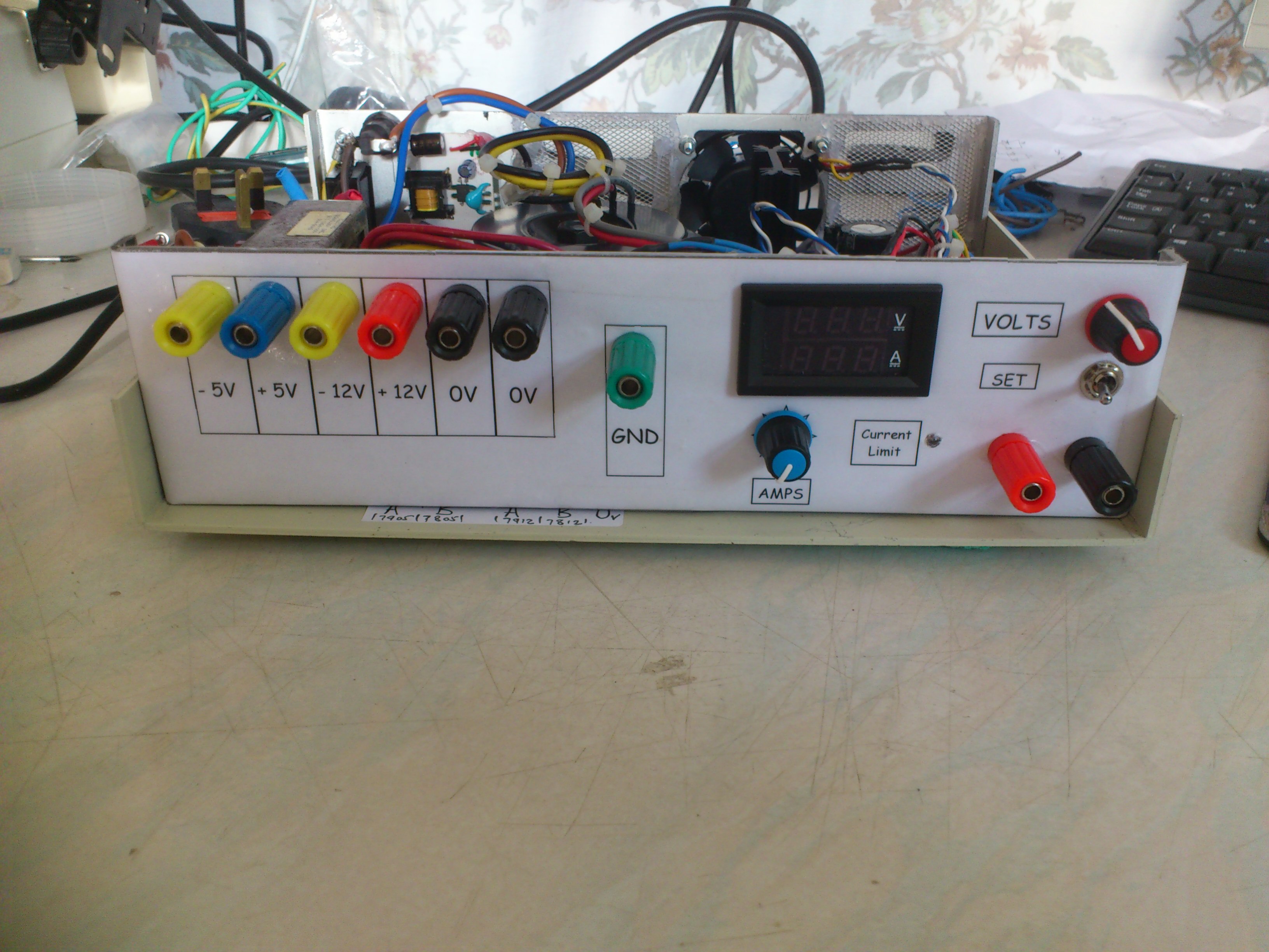

I've recently built myself a PSU which includes a chinese 0 - 30 vdc kit I got from Banggood .. .. very pleased with the results except that the variable volts and amps controls are a bit approximate and very difficult to adjust accurately. I've been reading and think that the answer is to change the pots for multiturns - quite straightforward.
However, the existing pots are not marked at all and the chinglish parts lists describes them as 10k W .. Am I right in thinking they are 10k 1W ??

My immediate concern is that the 2 pots used for adjusting volts and amps are single turn and difficult to use so I wanted to fit some multiturns instead. The pots in the kit are not marked, but the parts list says 10k W which I interpreted as 10k 1 watt. I was just trying to check out my theory.

True, but I don't have room on the front panel for big knobs ! I've ordered two 10k multiturns with 4mm shafts and a pair of knobs to suit :angelic:

I realize that you are panel space limited, but my preference is for two pots, one course and one fine. It gives you the resolution for setting the voltage you want, but you can get there faster.
The way to implement that is to add a 1K pot, wired as a rheostat, is between the top of the 10K pot and it's supply voltage. You don't get the same trim range across the full operating range, but it is better than a single, one turn pot.
