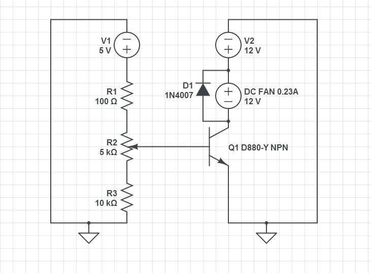

So lets say we have two voltage sources, and a dc fan, and we want a user to control the fan speed manually. Lets say one voltage source is coming from a micro controller and the other in independent.
Voltage Sources: 12v and 5v
First of all we do not want the fan to drop before its rated stall current of 5 volts and we want it to use a max rated voltage 12 volt.
We are using a pot to control the current to a npn transistor. Attached is a working schematic that does exactly what we want. I'm having trouble understanding the math involved with the voltage divider on the 5v side. Calculating the pot is confusing me. If I put a 10k pot the fan will not start until I turn the pot a bit(current is to low) to the base of the transistor. Can someone help me explain the math?
You have to put resistor between pot and transistor.
Current trough the pot should be 10 times larger than base current and, base current should be 20 times smaller than motor current.
Maybe you should use Darlington.
Currently on the left side you don't have a voltage divider because base-emitter junction is acting like a diode.

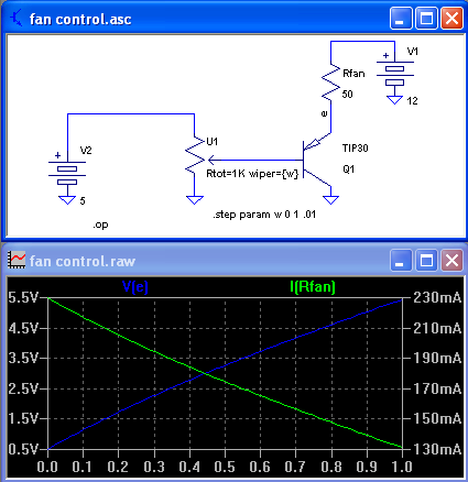

You're on the wrong track with that circuit. You need a PNP emitter follower. The transistor will get a little hot, but it won't hurt it.

Why a PNP emitter follower? NPN seems to be a lot more common configuration. Also what is wrong with the Darlington pair, the only downfall I see with this is the increased voltage drop between the junctions but would let me use a much smaller base current to drive the load. At this point i'm trying to figure out how to prevent the fan from reaching stall. If you turn the pot in (off position we will call it) I don't want the fan to turn off but run just above its rated stall voltage. So if you were to turn the fan off it would also start up at that speed without having to turn the dial up and then down again to get past the stall.

He wants to get nearly 12V across the motor when the pot is at one end. With an NPN emitter follower, he will get no more than 4.3V. The motor will never start.
Painstream, with the circuit you have (changing the NPN to a Darlington, or not) will give you very nonlinear response to the pot. I showed you the plot of voltage vs pot position for the PNP circuit. The minimum motor voltage is (12-5.7)=6.3V. The maximum is 11.3V.
