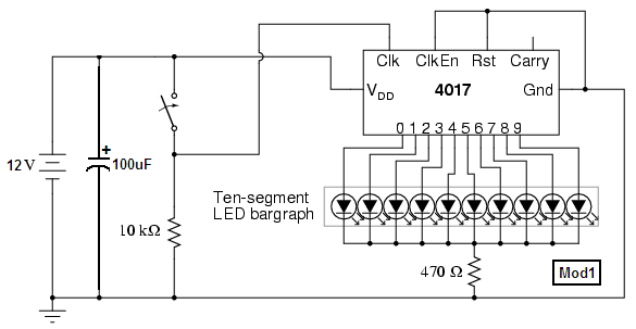

Hi all. I wanted to add an on/off switch to this from Radio Shack and connected the ground plug to the ground on the battery, the middle power plug to the positive on the battery, and the remaining plug went to power input for the circuit. IE: The switch sits between the battery and the 1M ohm resistor on the picture.
I have alegator clips on the battery terminals and when I run the circuit with the new switch, the clip on the negative terminal of the battery gets hot. I assume that this is not a good thing. Any hints on what is happening?
I'm a newbie to circuit designs so I'm not sure what is going wrong.

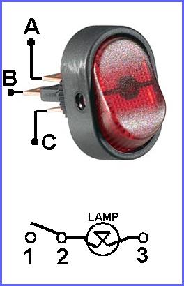

I can't tell which connection is which so I posted the switch and its electrical connections here.
Hopefully someone can tell you which terminal is which. The point is terminal 3 should be connected to 0V(negative terminal of battery). Terminal 2 to your circuit and terminal 1 to +12V battery via fuse.
If you own a multimeter, test the resistance between each terminal and one other. If that resistance changes from zero to infinity with operation of the switch then you have found terminals 1 & 2. If the meter reading is not zero and not changing with switch operation, then you have found 2 & 3.
If you are still in doubt, you will have to ask the supplier for switch connection.
Don't ever forget to use a suitable fuse at the positive connection to the battery.

pin 1 to + of battery pin 2 to the positive of the circuit and pin 3 to the negative of the battery but pray how r u gonna power the 12 V bulb in the switch from the 6 volt battery

I know someone will said that. OK, so which terminal is 1? A,B or C?

eblc1388 said:
I just noticed that you have the connection diagram. Please posts it here.
According to the diagram on the side of the switch:
Top connector is called Power (A in your picture)
Middle connector is called Load (B in your picture)
Bottom connector is called Ground. (C in your picture)
This is what I did origonally. This is what causes the the negative pole on the battery to get hot. :)
The filiament of the lightbulb has a positive temp coefficient. Is it possible that it draws a hundred milliamps or more at 6V, when it is rated at only 50mA at 12V? :?:

The LED currents will be higher with a 12V battery but the 470 ohm resistors will limit the current to a safe level.
The 4017 sequencer circuit doesn't need ten 470 ohm resistors, only one output is active at any time so a single resistor will be fine.
