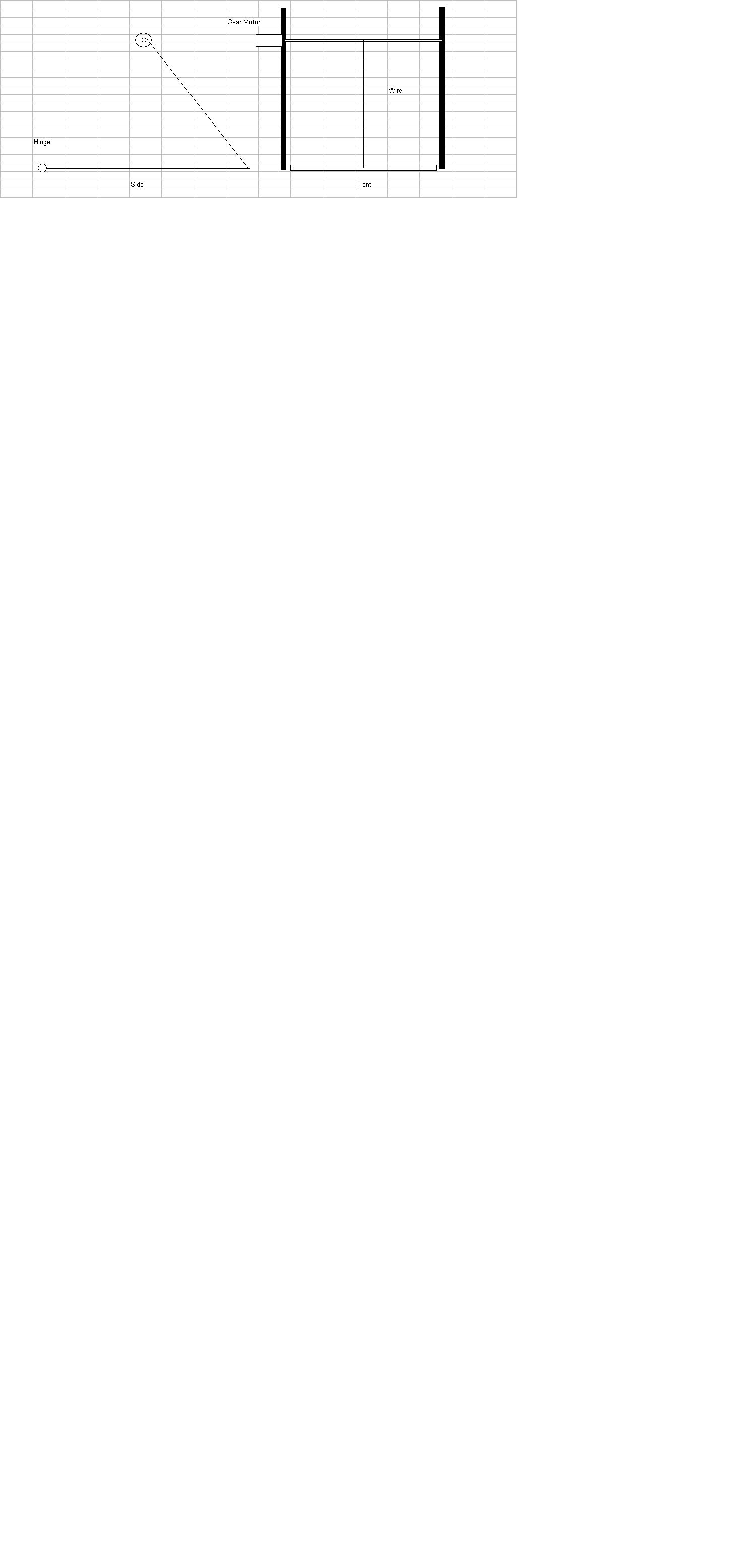

I am trying to install a simple pneumatic cylinder in my homemade incubator .The incubator has a rack which carries eggs.The cylinder is to be actuated hourly so that the eggs in the rack are tilted at an angle of of 45-60 degree to exercise the developing embryo.Period!
I need some education as regards the accessories i need to order together with the cylinder and the air be4 the whole thing can work.

Eggs huh? You may want to also look into small lead screw type actuators so you don't get scrambled eggs. I am thinking "gentle" is important. Someone mentioned a lead screw type actuator and that might be a better choice.

Hi kwame,
you don't require any linear actuator for the egg turner. Put the pivot point of the egg tray in the center of it and connect a geared motor via a crank shaft to either side and distance off the pivot point of the egg tray to gain the desired tilt angle. Use Hall sensors to determine if the final position (left and right tilt) has been reached to stop the motor and restart the timer for the turning cycle.

Egg rack
Unless it is much larger than I think a small gear motor may be enough. A 4 or 5 rpm motor would have a lot of torque. If you don't like the wire it could be some screw stock threaded in a nut on the rack with the motor in the same plane as the lead screw. I think this would be easier to implement and maybe smoother than the air.

Hi folks
i think a 5 RPM 12v Dc motor will be easier than the cylinder.I prefer using a gear with lever attached to the end which i can easily couple to the trolley(rack).
I want a gear which can tilt the trolley at an angle of 45-60 degrees.Folks do you know where i can find this sought of gear;preferably a one ,made of plastic?
