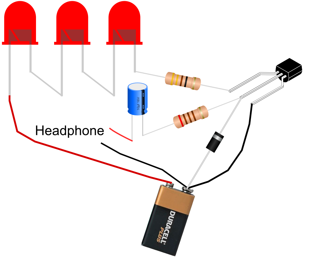

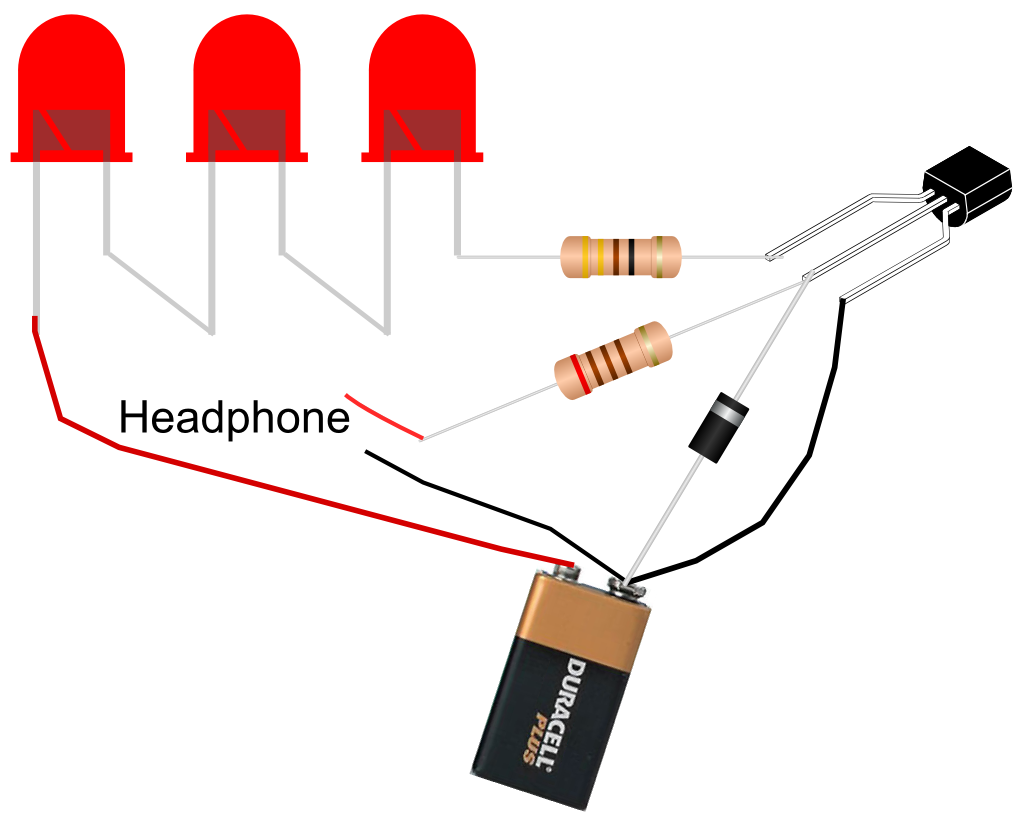

Here's a simple idea which will work. It's designed for 12V operation but it's fairly easy to change the design so it works from a couple of AA batteries. It should also work as-is from a 9V battery.
Here's a more nube friendly version of the schematic posted above.

You show a transistor on your side of the world (BCxxx).
The pins layout are different on my side of the world (2Nxxxx).
That's the problem with pictures, they may be nube friendly but they don't account for different pin-outs.
I did say it was the BC548 but the original poster might substitute it with a backwards transistor and it won't work.

My friend, i have tried your plan but it didnt work. The leds were lit but there is no sync with playing music at all. Could u review and help me out again. Thank u!
The extremely simple circuit will light the lEDs continuously if the music source has a positive DC on it. Use a 10uF coupling capacitor.
It is shown with a BCxxx European transistor. Turn around a 2Nxxxx american transistor.
How many small battery powered headphone amplifiers do you know of are DC coupled?
It's possible that the circuit has been connected incorrectly.
Maybe the collector and emitter connections have been reversed?
Anyway try this and if it doesn't work reverse the transistor connections.
Look at both the real schematic and the picture, it will help you understand how to connect components up so next time you won't need a picture; the schematic will do.
Look at the datasheet for the transistor you're using; this can normally be found by Googling for the part number which is written on it. The datasheet will tell you what eash pin on the transistor connects to .

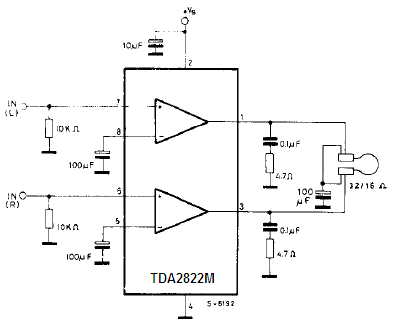

I was thinking of the circuit shown on the datasheet of the TDA2822M stereo amplifier IC made by ST Micro or SGS-Thomson or whatever they are called today. Their photo-copier or scanner is horrible.
So the returns from each transducer are connected to 0V via a single capacitor, have I got that right?
There shouldn't be much DC because the amplifier are on the same IC so should be pretty well matched.

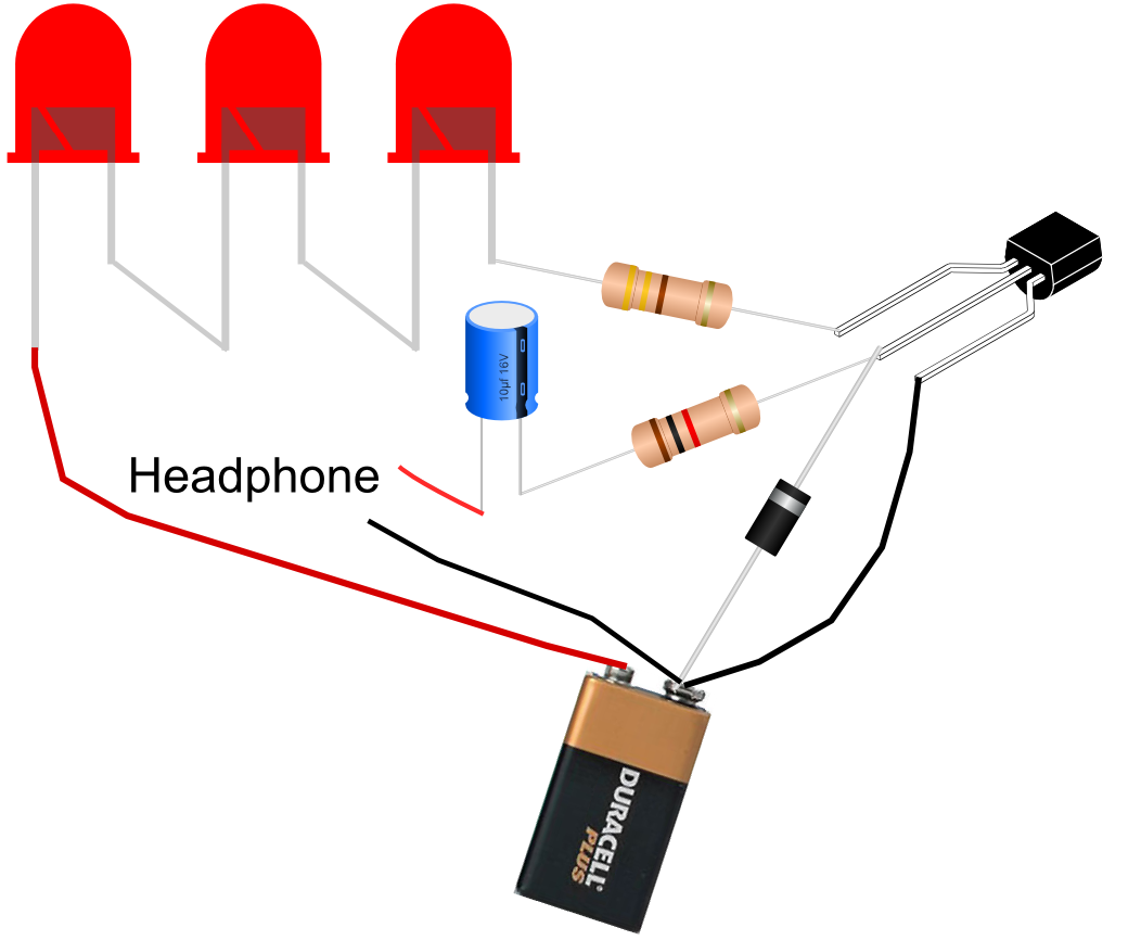

I can't believe you didn't spot my deliberate mistake. ;) I got the resistor colour codes wrong. The 1k resistor is drawn as 2k11.
I should've also used four band codes for 5% tolerance resistors. Five band is never used on 5% because it it specifies too many digits for such a wide tolerance.
I've corrected the drawing.

The TDA2822M stereo audio amplifier has outputs that are at half its supply voltage so it might turn on the LEDs continuously which is the problem experienced by the OP. Maybe his audio player is the same and needs a coupling capacitor to feed the transistor that drives the LEDs.
I ignored your 1% resistor values but now I notice that you made a 440 ohm resistor.
It's 330R, orange, orange, brown.
Perhaps the orange looks too yellowish?
I've changed that, not it's definitely orange, not orangish yellow.
