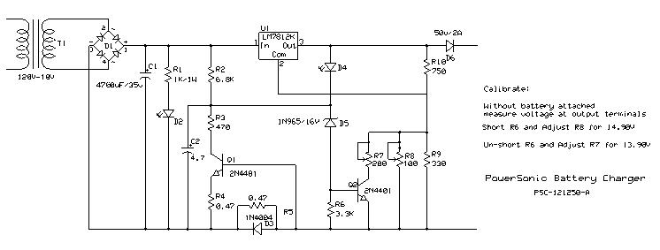

Its a lead acid battery. I'm quite sure it's not deep seal, but not certain which other one it is. I'm sorry for not answering ur question.
I'm assuming you mean a 12V, 4Ah SLA.
What sort of charger, fast or float?
A float charger is simple, just make an LM317 voltage regulator with an output of 13.8V and connect the battery to it. It will take a long time to charge but is simple, cheap and reliable.
A fast charger is slightly more complicated, charge to about 14.8V limiting the current to <4Ah, when the current drops below about 400mA the battery should be either disconnected or allowed to float at 13.8V.
Ok, lets get this straight. The battery should be used to power a 40w inverter: i suppose 12v 4ah SLA will be ok. Power supply in our area is quite epileptic so i think the fast charger would be best. And should be automatic. Would you mind helping me with schematics.
Use a 15V transformer, and a 4,700µF capacitor.
Connect it to this circuit:
Connect a 100nF capacitor aross the output and use 220R and 2k2 for R1 and R2 respectively.
