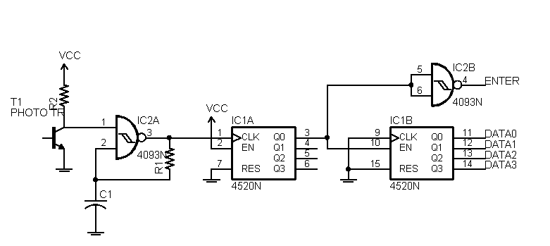

Or you could build this circuit. Place the photo transistor near the "Go" light, attach the ENTER and DATA0-3 leads, turn the power on and let yourself in.
(Note, this is untested, but I think I've got all the timing details correct.)
