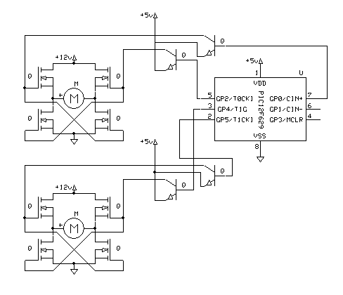

Im using the 12F629, and have a problem.
I took apart a cheep RC car and Im going to use it for the chassis for a simple robot. The Motors for the chassis use 6V power input to function.
I built 2 H-Bridges to allow the PIC to control the Motors.
The power input Im using for the PIC is 4.5V or 5V.
The PIC fails to run at all. I have manually tested the H-Bridges myself and am confident that the problem is the controller.
The PIC fails to run anything. I can get a good varification for the program after flaching the chip.
I unplug the power and then reenable the power on the robot and only once in a while will the PIC activate. Then it only works for a few moments then cuts of.
I've even replaced the batteries to ensure that Im not getting a brown out.
Can anyone shed some light on whats happening please?

Hi pixelnsprings... my guess is that you're not using a 5v regulator, or thatyou've not decoupled the power supply with appropriate/enough capacitors.
If you can attach a circuit diagram we can comment more clearly and give you some salient advice...
Paul
Actually using a 5V regulator was my first attempt. After failing with the regulator I desided to use a seporate power supply for the PIC - 5V. and 12V for the motors.
And here is the schematic Im using.
The controller fails even if I simply put an LED and resistor connected to an output. I also hooked an LED/resistor directly across the power rails to make sure I was getting a proper power connection.

You need an "LDO" Low Dropout 5V Regulator... and run it from 7.5V batteries just to be safe (the LDO will keep working as they discharge.) That or switch to the LF version of your PIC which will run from 2.5-5.5V and use an LDO 3.3V regulator in stead of the 5V one if only to isolate it from noise from the motors. In any case you need a tantalum cap across the output of the regulator, and some .1uF caps as bypass to catch high frequency noise (and a 1uF one across the motor too.)
Now I'm not an H-bridge expert so can't comment on that with any certainty
