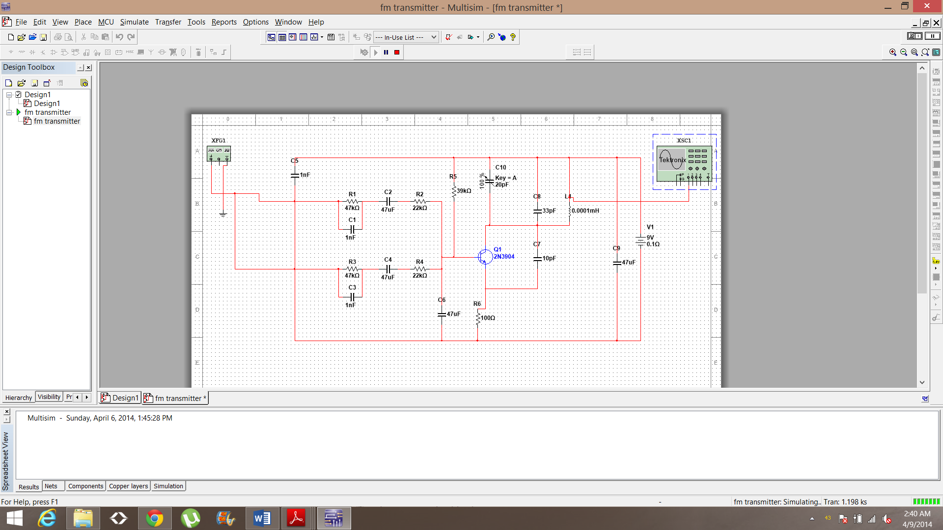

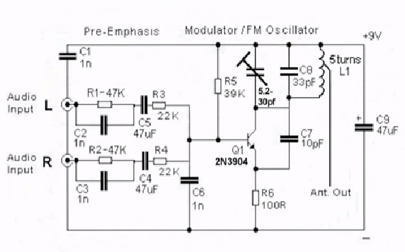

so i tried simulating this circuit on multisim.. uses an audio input i switched that with a function generator.. and the output is at the inductor .. i can only seem to get what im putting in at the input of the function generator.. no modulated or amplified signal.... im really bad at this software stuff.. any suggestions are appreciated.. (in the plainest english possible, im not good at this electronics lingo)
its not letting me upload the file i made on multisim .. so ill just take a screenshot instead.
anyway about the inductor.. its a 5 turn copper wire on a 3.5mm drill bit.. im not sure how to find the inductance so i just put an estimate.. :/

The drill bit is used for winding the coil for the right diameter, not as core material.
Your estimated inductance is about 2000 times too big.
Here is a calculator for single layer air cored coils: **broken link removed**
Apart from the inductor value, I see the following problems with your computer game errr sorry simulator,
The inputs from the function generator connect to the 0v line from C5.
There are no "earth" connections for the main circut or the scope.
The value of C6 is too large.
The connection from the scope to L1 is shown going to the +ve supply rather than a tapping point on the coil and would never display anything anyway.
Also, what are you expecting to see from this simulator?
I have a feeling that at best all you will see is the RF waveform, you will not see the effects of frequency modulation which will probably not be accurately simulated.
