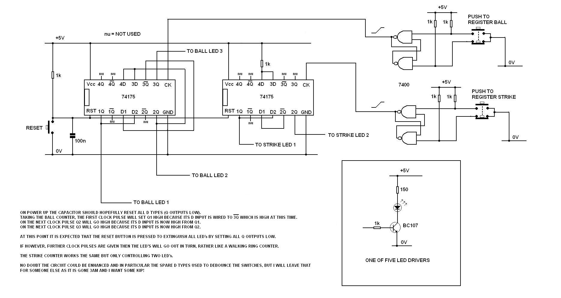

PLEASE HELP ME?? How do I bulid this circuit (debounce)
T
theitalianone234
Guest
So i am a college student, i am taking a digital logic controllers class, and for our final project that is due next week the professor assigned us to design and construct a baseball scoreboard using a debounce circuit. he just wants us to make the circuit for balls and strikes using a total of 5 LEDs two for strikes and three for balls. and they have to coinside with eachother for example if u have one strike and three balls, then you get a fourth ball all of the lights should reset. So i am at a loss. He didnt really give us to much to work with. He gave us two DM74175N 16 PIN chips and said it may come in handy and told us to check through some of the chips we already have. So if anybody could help me to try and come up with a schematic for this i have no idea how to!! and if i dont get this done i fail the class!! so please help me out!!

and by the way, I wouldn't use a schmitt trigger to debounce. however, a ff might come in handy. heh heh
I disagree with this. You can use a FF but it requires a SPDT switch which may not be convenient. You can do it with a SPST switch floowed by a RC low pass and a Schmitt Trigger.
I have posted such a debounce circuit in this forum (or electronics chat) a year or 2 ago. So if you search using "debounce" and "ljcox" you should find it.
If not, I'll post it again.
the instructor gave him a d ff. with a wink.
and yes, a low pass with a very low 3db cut off is always a good idea.

Hi, I have attached a circuit that may give you a start, using the 74175's.
Probably not the best way of doing it but you should be able to alter it to your preference.
Cheers
Les G4CNH
P.S. I should have refreshed as I did not see all the later comments, Oh! well, I still feel it a duty somehow to try and point peeps in some kind of direction and it may give encouragement for further reading. I remember having similar problems when I was trying to build my first Z80 micro and a little help from mates gave me much encouragement to self learning.

well thank you for your post and thanks for the schematic!! i apericate it a lot!! and see the people that posted all those things that wernt to nice dont know the whole story!! if they would have known that i dont have the prerequest for the class becuase the advisor messed up and i couldnt get my $$ back so i stayed in the class and i am trying my hardest to get through it!! then they wouldnt be talking all that ****!! but o well... thanks a bunch!!:)
