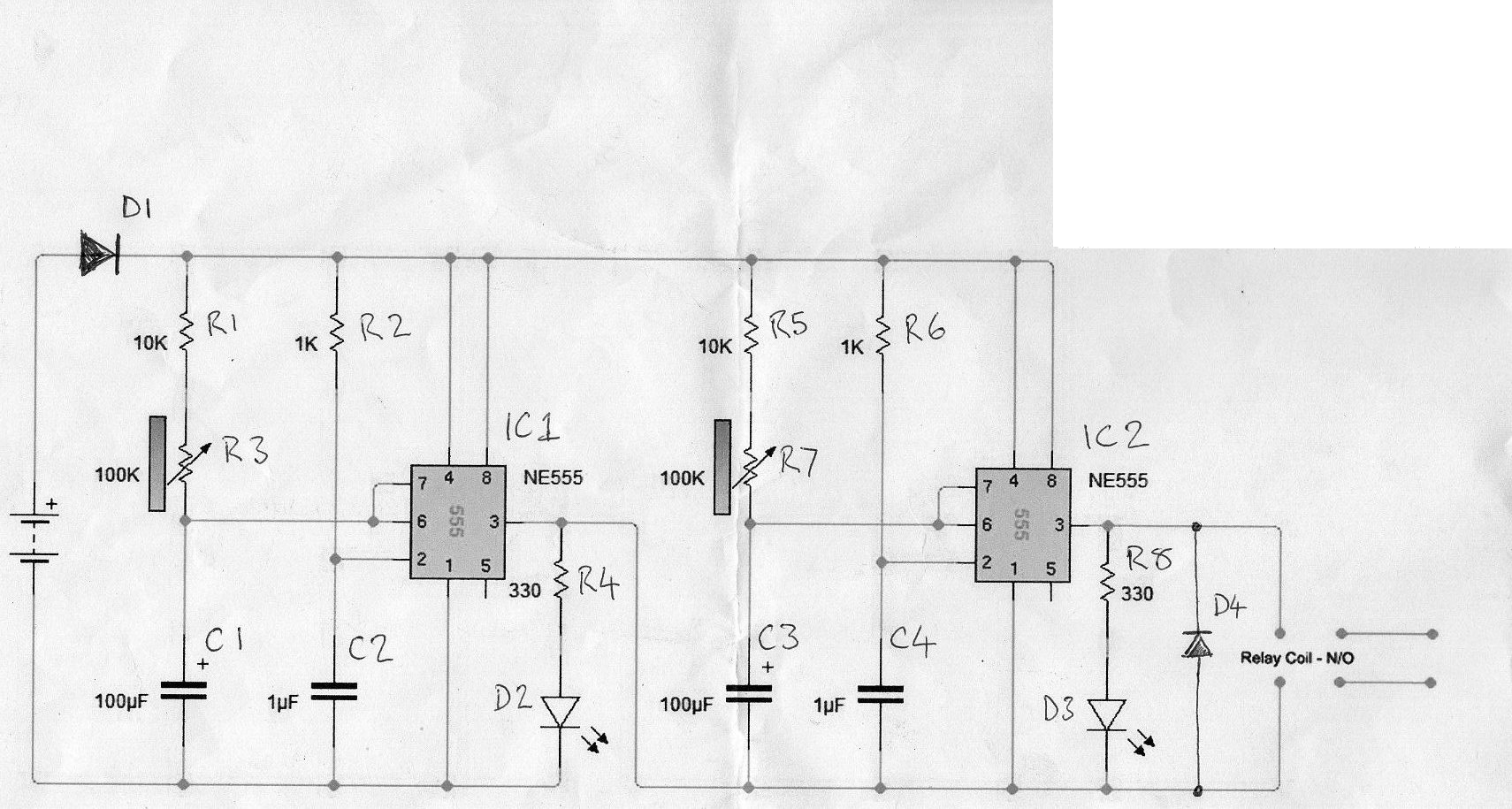

ok the deal is i am using the tv as a monitor with a small pc unit to play movies. the main power is fed through the pc which then once powered up powers the tv. i have had no problem with this in the past as i would just bridge the power and grd pins on the board from the inverter to the key board. unfortunately they discontinued the model of tv that i was using. the new model (telefunken TLCD-19JA) has an external inverter so the pin slot that i used it no longer in use. the power button on the tv is a push on push off that has two leds red and blue. i have tried bridging it but it would then just loop the power up (like i was consistently resetting) i have narrowed it down to a grd pin and k7 pin but only works on a pulse and cant be bridged. i am still new to electronics so not to clued up on technical terms. I am desperate because it is a part time business of mine and i am running out of time to find a solution. thank you
Assuming the set always powers up in standby, then you can use two simple 555 timers, one as a powerup timer (to give the set time to finish settling down), and the other to briefly short together the ON/OFF button.

Assuming you can program PIC's? (if not use a PICAXE which is dead simple, and still cheap) then you just need to have a PIC pin feeding a transistor, which feeds a small relay - with the relay contacts wired across the switch.
Simply program the PIC to wait ten seconds or so after power up, and then set the I/O pin high for one second -after that set it low, and put the PIC in an endless loop.
I've just dug this out of my archives. I think this is probably similar to the circuit Nigel was reffering to.

Pin 4 of the 555 is the enable pin - the best way to connect two together is to connect the output of the first to pin 3 of the second.
