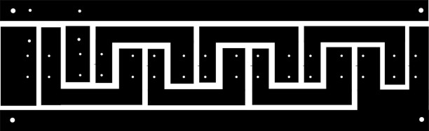

Finally got around to etching some PCBs this morning. These strips are growlights, using 8 Piranha LEDs, alternating red and blue. The 4 reds, I'm using a 47ohm 1/2 watt, and a 1 ohm 1/4 watt resistor for the blue. Using a 12v 500ma wallwart for supply. No heat issues after 5 hours.
I had a lot of trouble with the reds. Between the two strips I made, had to replace 3. Not sure what went wrong, maybe soldering abuse, but don't think so, least not entirely. Out of 16 LEDS, only screwed up one, three times before getting it right. Guess you can't really complain about chinese quality...

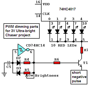

PWM is a dimmer for LEDs as in my Plants Watering Watcher project and in my Ultra-bright Chaser projects.
The lower power consumption is because the average current of the LED and therefore its brightness are less. My Ultra-bright Chaser projects have such a low battery current when the PWM has an extremely narrow pulse (dimmed) that they operate for a very long time on their small battery and don't need an on-off switch.
For your fader project the LEDs must appear continuous and gradually become bright, so PWM won't save much battery power. I have some 3-color faders that operate from a wall-wart adapter.

The dimming circuit is a Cmos Schmitt-trigger oscillator with its duty-cycle changed with a pot and a couple of diodes. It dims from zero to about 98%.
The parts still work when the 3V battery (two AA cells) drops to 2.0V and the current is low because the LEDs each flash very briefly (about 30ms).
Going to save that, might be useful in the future if need to adust the brightness of one or more LEDS.
